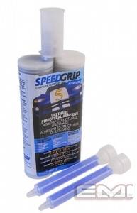

I do keep norton 5 minute PB in stock...... it ha soooo many uses....... you can almost build a car with this stuff
