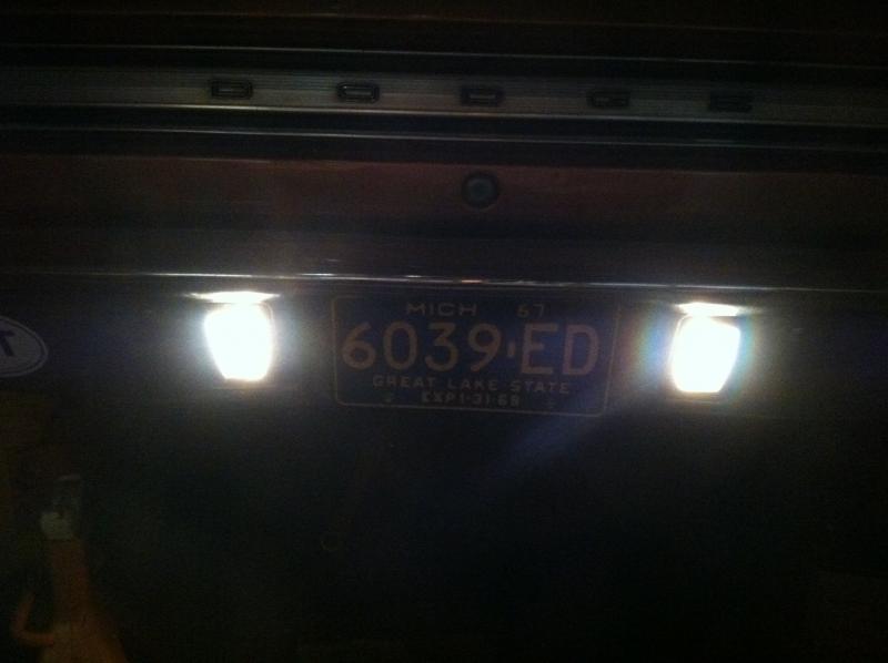

It all started with a bad voltage regulator and alternator. Replaced the melted wires in the dash harness to the amp meter a new headlight and turn signal switch and now everything works. All the gauges. All the lights, dome, map, trunk and even the emergency flashers. Last thing was one backup light. Bad ground around the socket to the lamp housing.

Well now EVERYTHING works. I hooked up a glovebox light and just put my reconditioned am radio in. I have to say I'm kind of proud of myself. 45 year old car and I got it all done.
