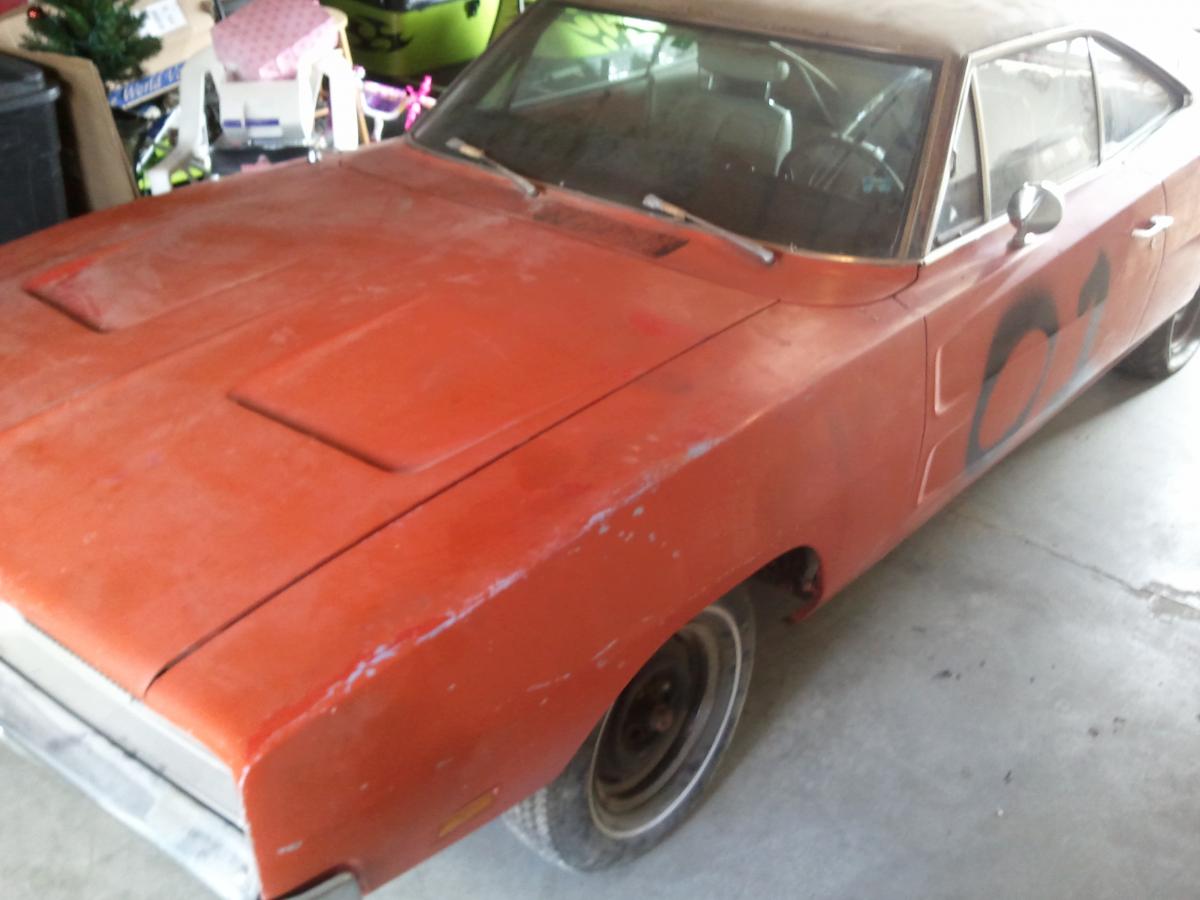

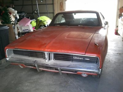

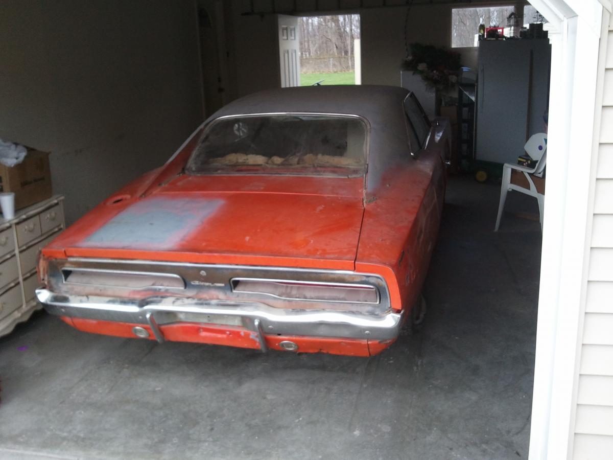

Well after years and years of searching and looking at overpriced rust buckets
I stumbled upon a Craigslist deal, unmolested 1969 Charger all complete, car has minor rust in the lower quarters which I will replace, needs a trunk floor and I will probably put a set of framerails (driver side looks worse) taillight finish panel (not because of rust but driver quarter had been dented pushed forward about a inch, floor pans are solid as well as all the frame and inner fenderwells, all the sheetmetal is original and the doors,fenders,hood decklid! wow, I mean I was speechless, It is a factory Red 318 car and had a vinyl top (top had been taken off and is clean as all getout no rust) has a crap
rear axle its not a 8 3/4" for sure (has a cover on the back 8 1/4"?) Interior was white with black dash and its totally complete dash pad has no cracks,
the front grille is all there with all the trim, couple pieces are cracked but I can repair it no problem, center stainless bar is bent to crap! It will need bumpers, 318 does not run but I have a 440 that will go in it. Im sure some of you will want to bash me for what the car will be! (wink wink) sorry but if it doesnt have a big rebel flag on the roof and isn't orange its not gonna be what I truely want since I have been 5 years old! There are not many pieces I need, the only trim pieces I need are the driver side quarter panel extension and chrome (gone from where it was bumped) the Vinyl top trim that goes inside the rear sail panels (mine were there but the knucklehead that removed the vinyl top broke the arrowhead parts off taking them off!) I have every single other piece to the car. Sorry if I am rambling but im super pumped, I have seen 69' shells go for what I paid for this. I think I used all my luck for the year up on this one!!!

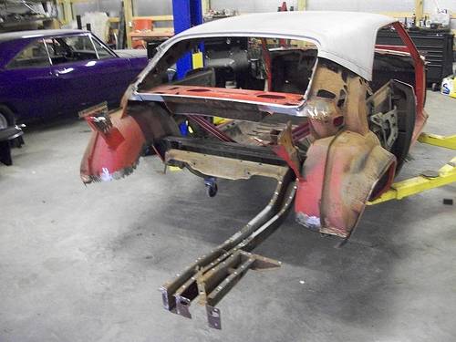

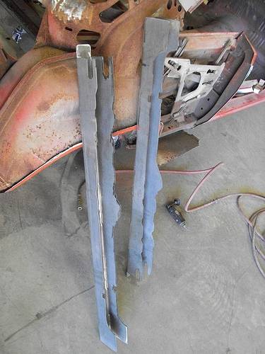

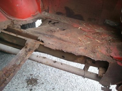

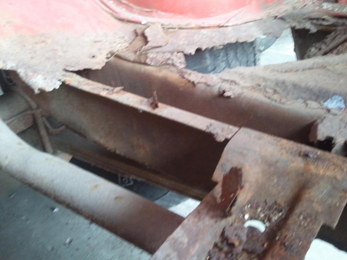

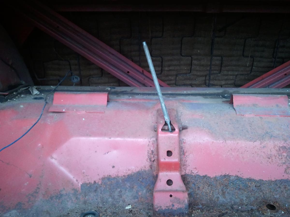

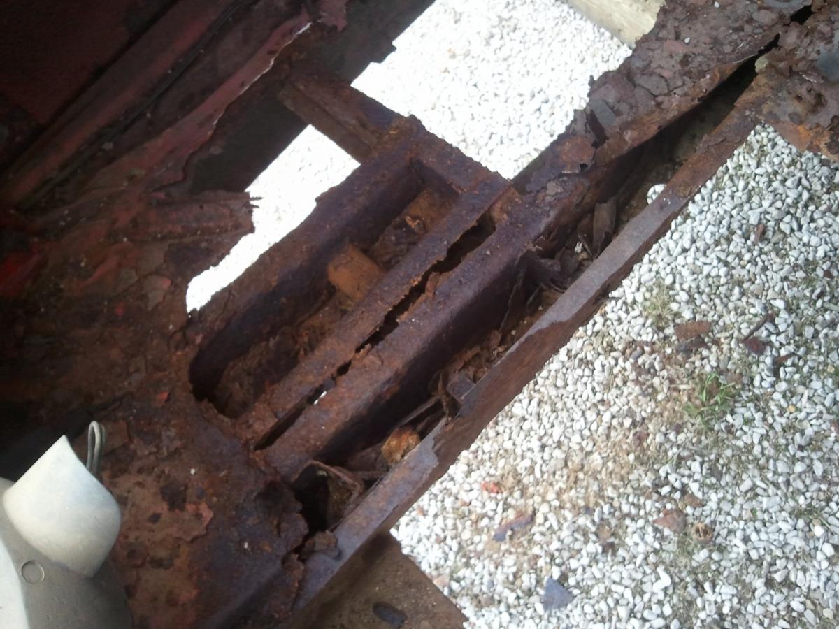

Now I have a couple more pics, who makes all the leaf spring perch and assorted pieces?? My Driver side is SHOT!!! The frame is toast and from about 2 inches behind the wheel well back is nasty nasty!!but the passenger side looks good no rot in the frame, I don't think I will have to replace the dutchman panel, I am thinking about just putting quarter skins on this car, won't know for sure but the outer wheel houses are solid I had the back wheels off today to put better tires that hold air!! and the wheel houses looked fantastic, Im thinking rear valance, tailight panel, full trunk floor,
frame section on driver side and leaf spring perch, trunk drop offs, valance corners. Let me know what ya think!

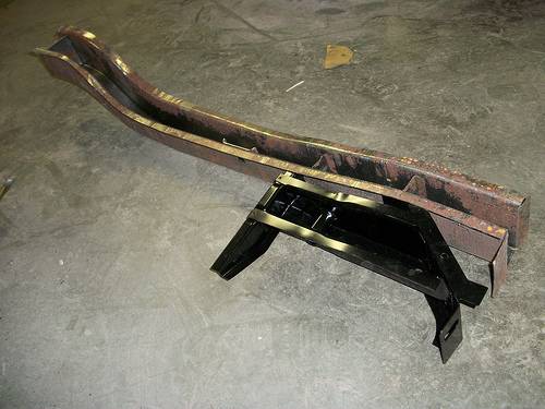

AMD makes your leaf spring shackle mounts. They also make full rear rails. I got my partial rear rails from auto body specialties. They tie in about mid hump above the axle and are tappered down at the last inch and a half so they can slide into your original rails
Hey Thanks propwash! I think thats what im gonna do section the frame right after the wheelwell, Im gonna go check out AMD right now. Thanks again!!

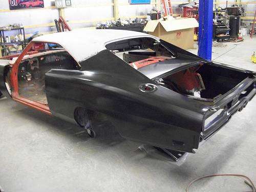

I have all my AMD sheetmetal just need to bust out the sandblaster this next week sometime and clean the backhalf up and shoot some epoxy before I install the driver rear frame rail, trunk pan, crossmember, spring perch and the outer wheel houses then on to the outer sheetmetal! hope to have all the sheetmetal all on within the next month, then back on to the rotiserre to do final clean up on bottom and weld in my US cartool subframe connectors and spray the bedliner on the underside.
