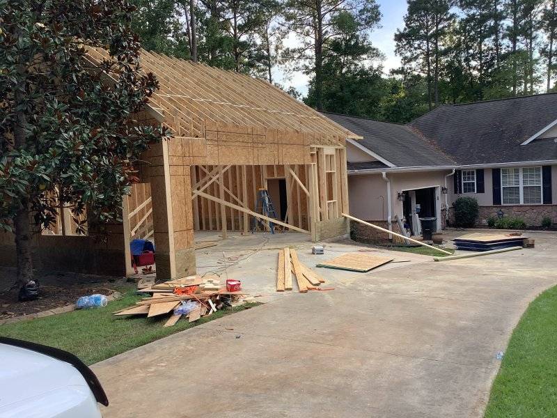

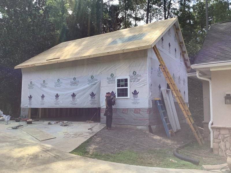

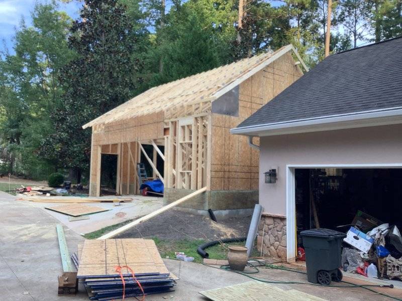

FINALLY!!! NEW GARAGE is framed up!
8stackhemi
1:00 PM
Dec 27, 2013
442
625
Sun-N-Clouds, SC
So far, this project has taken over a year......& is still going! Excavation problems, concrete problems, two civil lawsuits against two concrete contractors & still searching for the building contractor who took our 8K deposit to build the garage & left town unanounced, plus following up on other issues & debacles.....BUT we are finallly moving ahead!
It's amazing how many dishonest people are out there in this SC area. We retired here from MI about 8 years ago where all my friends worked in the trades & were HONEST people! Moving here & not knowing anyone has it's drawbacks, for sure, but i've NOW found reputable folks i can rely on & work with. Thank God!!!
I'm geeked that this is getting close to being done. Next big purchase will be another car lift similar to my 4-post in my existing garage. Whoopee!

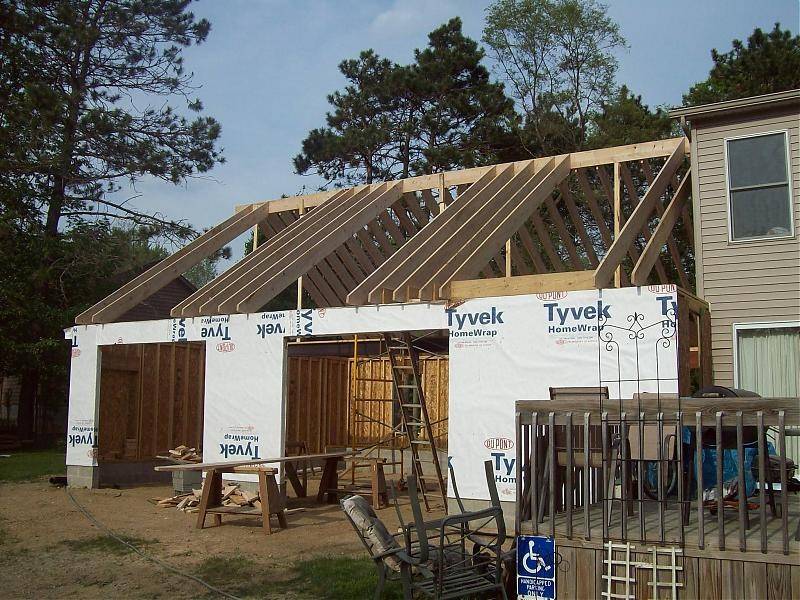

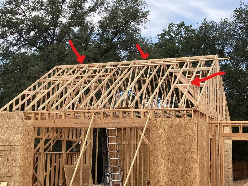

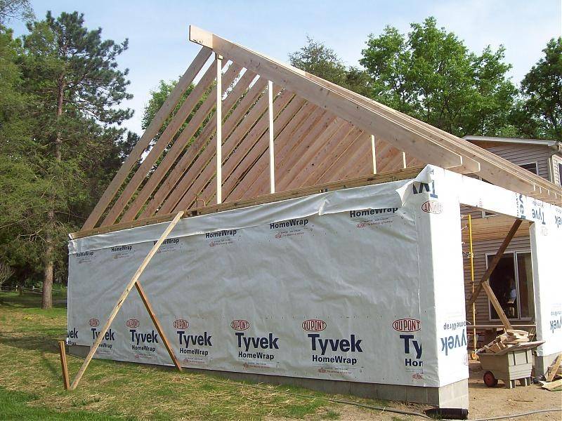

I know that construction standards vary a bit from zone to zone but this part had me curious.
Here is yours:

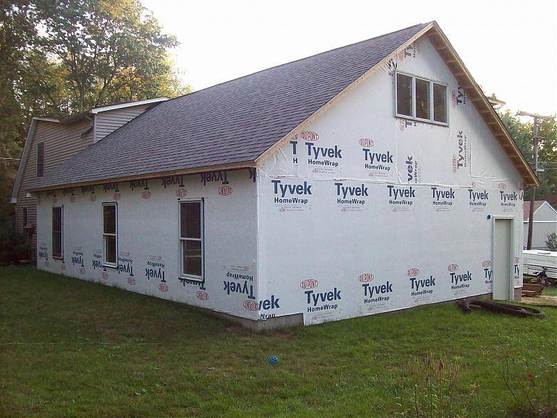

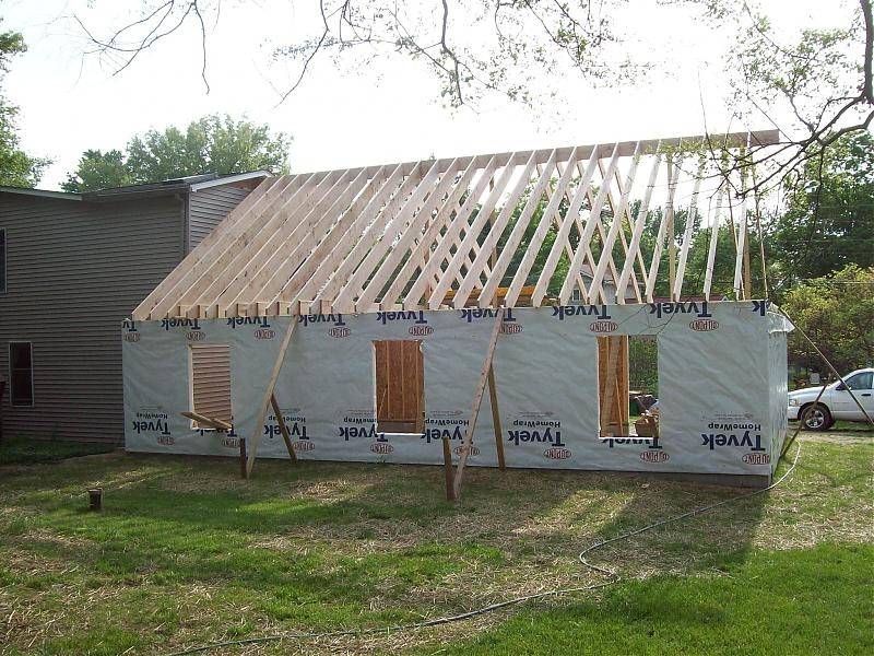

The next picture is a roof I framed last year. Note the blocking at the ridge and the diagonal bracing at the gable ends. I'm surprised that neither is required in your garage. Was that done and not shown in the pictures?
Both add tremendous torsional resistance in the roof structure.
Otherwise, everything looks great.
I'm not an engineer or builder but my shop didn't get those either.
The question is, is there a difference because of trusses as opposed to stick built?
The difference in blocking and diagonal bracing could have to do with different seismic zones. California is much more active for earthquakes than South Carolina. There are maps in the building code that show different seismic zones for the different area of the nation. California always had the strictest building code regulations in the country for seismic requirements.
Out here in the West, we have to build to earthquake standards. When the ground shakes, the buildings sway around.
Anyone in the path of tornados or hurricanes are at risk of wind pushing their buildings sideways off of the foundation.
In both cases, it is my opinion that you'd want as rigid of a building as possible.
Maybe the engineers and inspectors elsewhere have determined that the buildings are sturdy enough without the bracing and blocking.
Here, we have blocking at the wall line and ridge to make what they call perimeter nailing of the plywood sheathing. In some cases, we have to put blocks at every 4 foot to fully nail the perimeters on each sheet! The bracing from the walls up through the trusses into blocking keeps the whole roof intact and square. Every row of blocks that a brace is nailed to has to be nailed through the sheathing to tie it together.
Hey...if the building matches the plans and passed inspection, that is fine. I am biased in my opinions due to my entire body of work being in California where they go to the Nth degree on structural matters.
Here is yours:

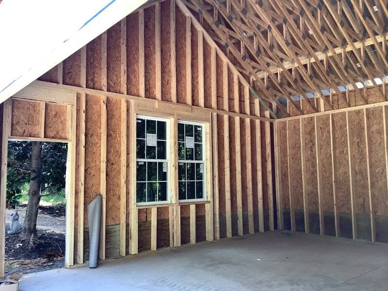

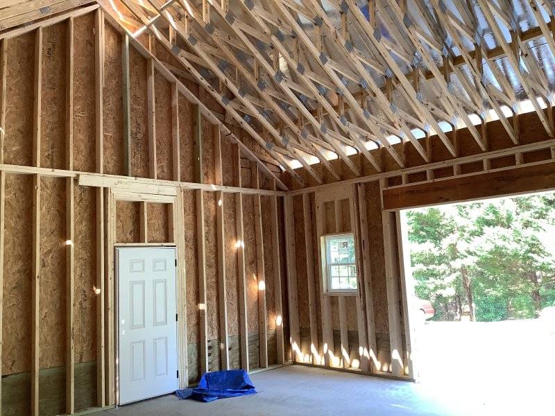

Appreciate the comments & suggestions. There is blocking at each truss, but due to the galvanized plates at the top joining the rafters, the blocking is moved down about 12" or so. Can't use the diagonal bracing you have used, since the trusses are designed/engineered for an 8/12 inner ceiling Identical to the 8/12 pitch outer roof. I did it that way for clearance for the two lifts i want to include. I could have built 12' or 13' walls & had an attic, BUT the structure would have looked enormous next to the existing garage. As it were the walls measure 11' tall outside (design of the truss) & about 10'6 inside wall height. I HATE HOA's and all the restrictions!!!!!! If i did not live in this retirement community, it would have been a STEEL BUILDING GARAGE, period, & TWICE THE SIZE. It is what it is.
Thanks.
Please understand that I meant no criticism, just concern. If the engineers and inspectors signed off on the design, that is good enough. Your lack of earthquake activity surely dictates some leeway in design.
I've had my own confidence shaken a bit these past few years.
Imagine that all your career, you're repeatedly told that "XYZ" was necessary and absolutely mandatory for structural integrity....then tear off drywall during remodeling work in an 80 year old house...to find none of it anywhere. Yeah, the house is still standing yet it has none of those absolutely essential reinforcements.
I helped a few friends with their houses and am always amazed to find framing under the drywall that would get me fired instantly on any job today.
It was a reality check. I've had to come to the realization that what I have been trained to think is probably way overkill for anyplace other than an earthquake zone.
