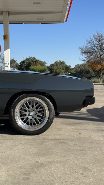

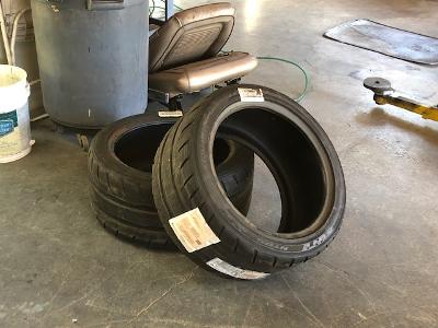

I love these tires...100 treadwear is soft for great cornering and braking but the shorter sidewalls aren't the best for drag racing.
What sizes are you running?
I first had 295-45-18s in the back but swapped to 295-35-18s. My fronts have been 275-40-18s since 2003.

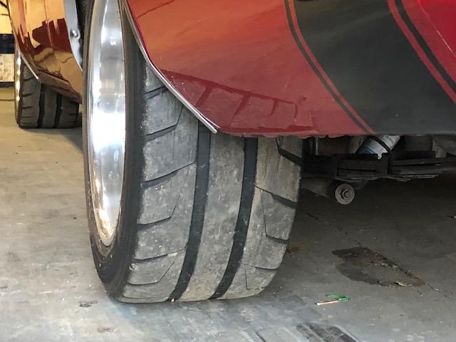

View attachment 1572111View attachment 1572112
I have 275/40/18 up front. I have a little rubbing but nothing crazy. The rears are 295/40/18 and fit fine.
I wanted to switch to the 295-40 for the rear but the price was unbelievably obscene! The 295-35 is a bit shorter than I'd prefer but they were $100 less per tire so I figured I'd try them. So far, I do like them.

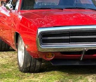

I can see why your fronts rub. They are set out a little further toward the fender than mine. Yours do look good though. Your car has a great stance to it.
I have a 9" front wheel with 4 3/4" backspacing. Maybe yours have less backspacing?
A bit of negative camber can tilt the top of the wheel/tire in a bit for more clearance. I run almost 1 degree of NEGative camber and no...the tires do NOT wear faster on the inside edges.
