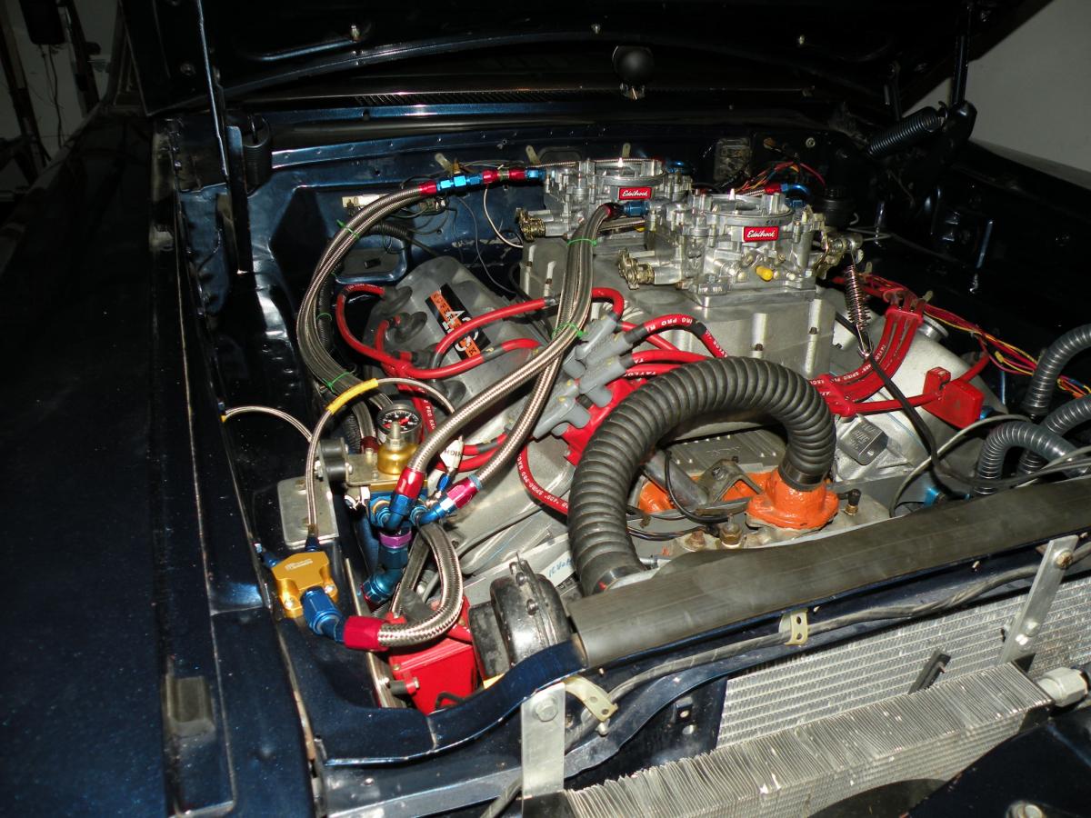

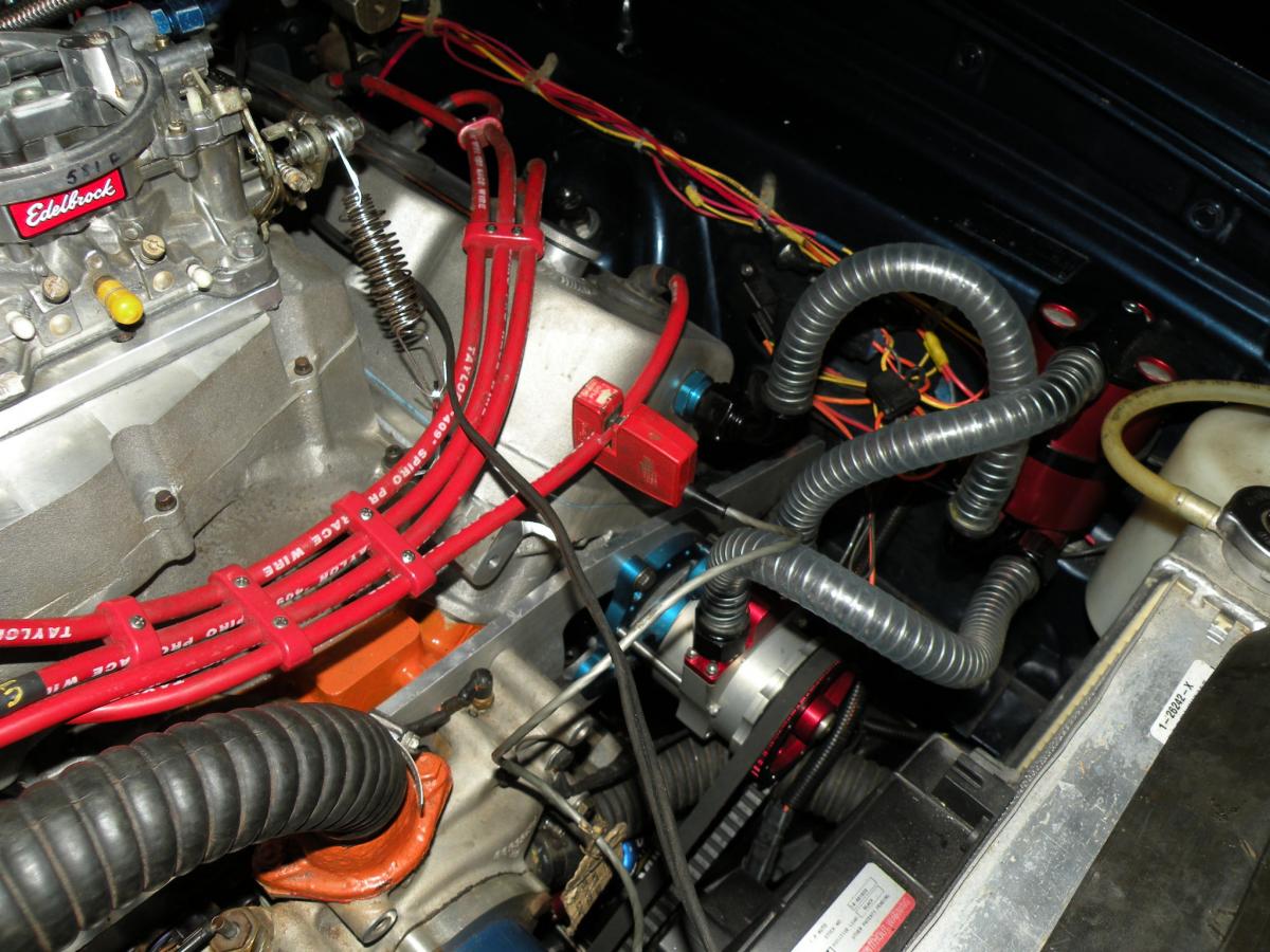

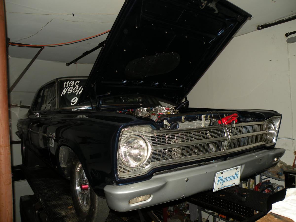

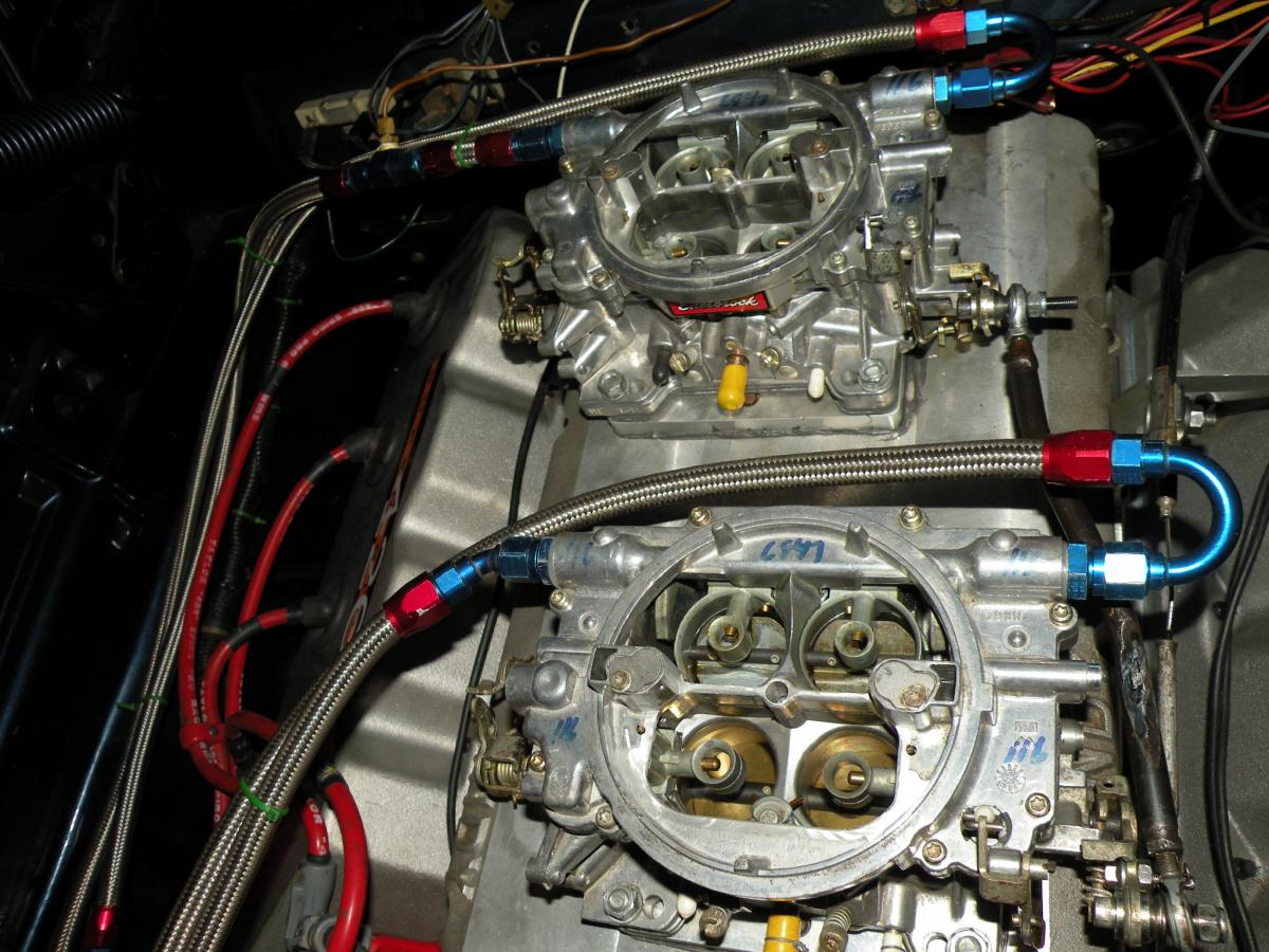

Been done for a few days now. just had a chance to put up some pics of the new bullet.
This one started the easiest yet with the new 16 volt turbo staert batteery and alternator.

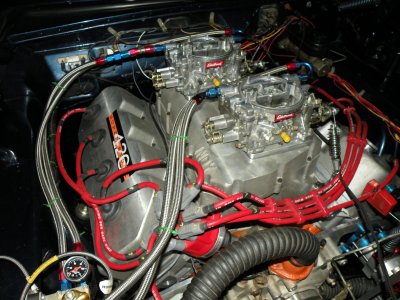

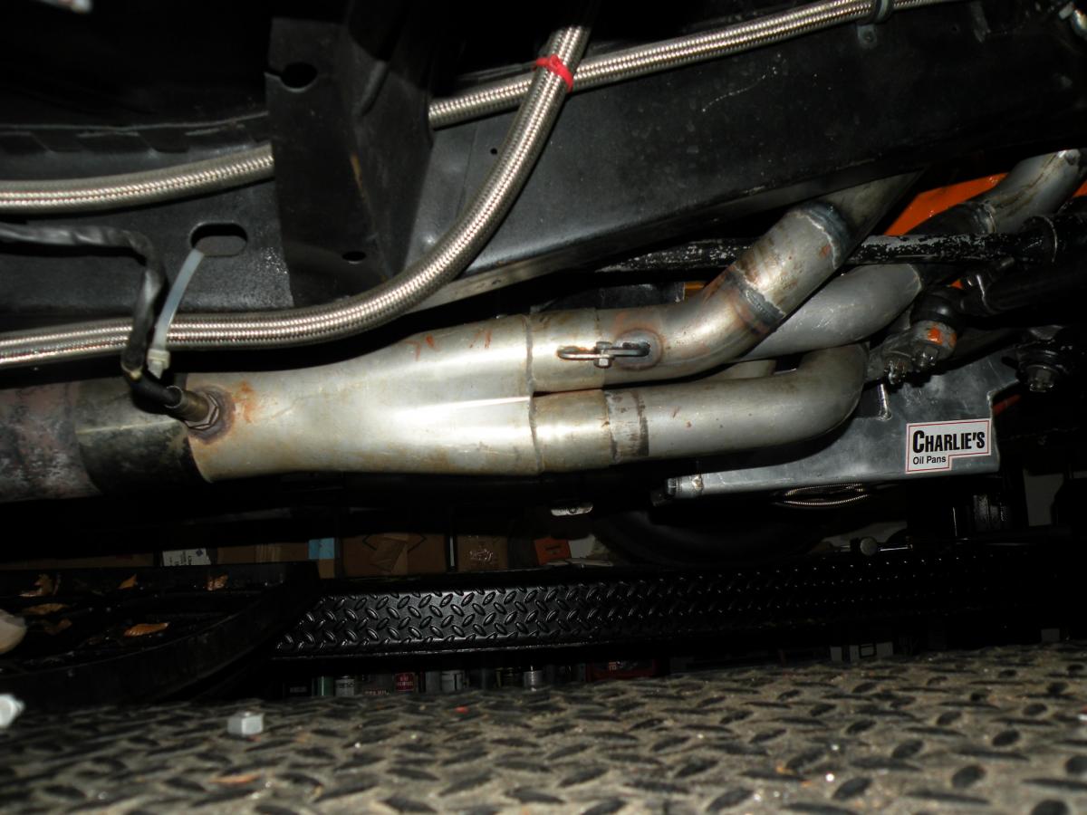

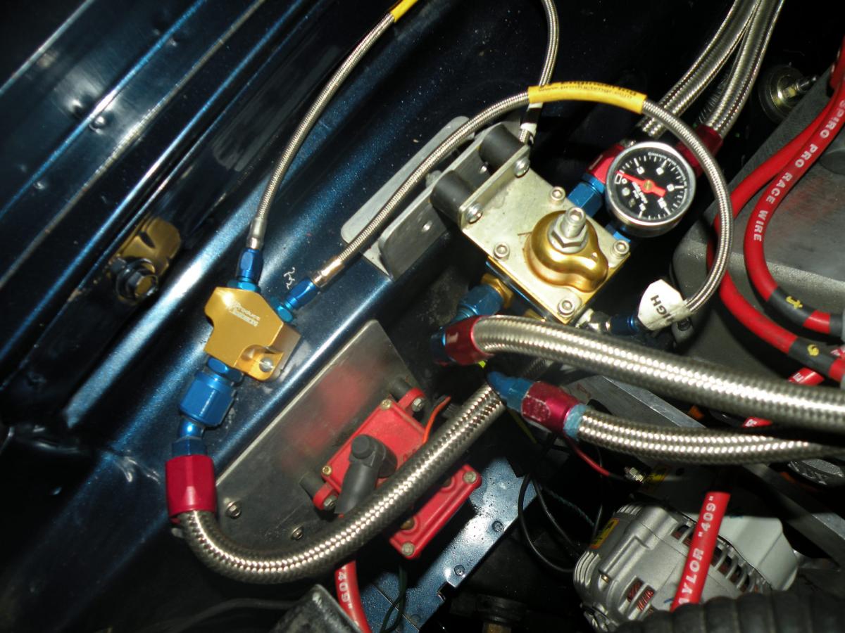

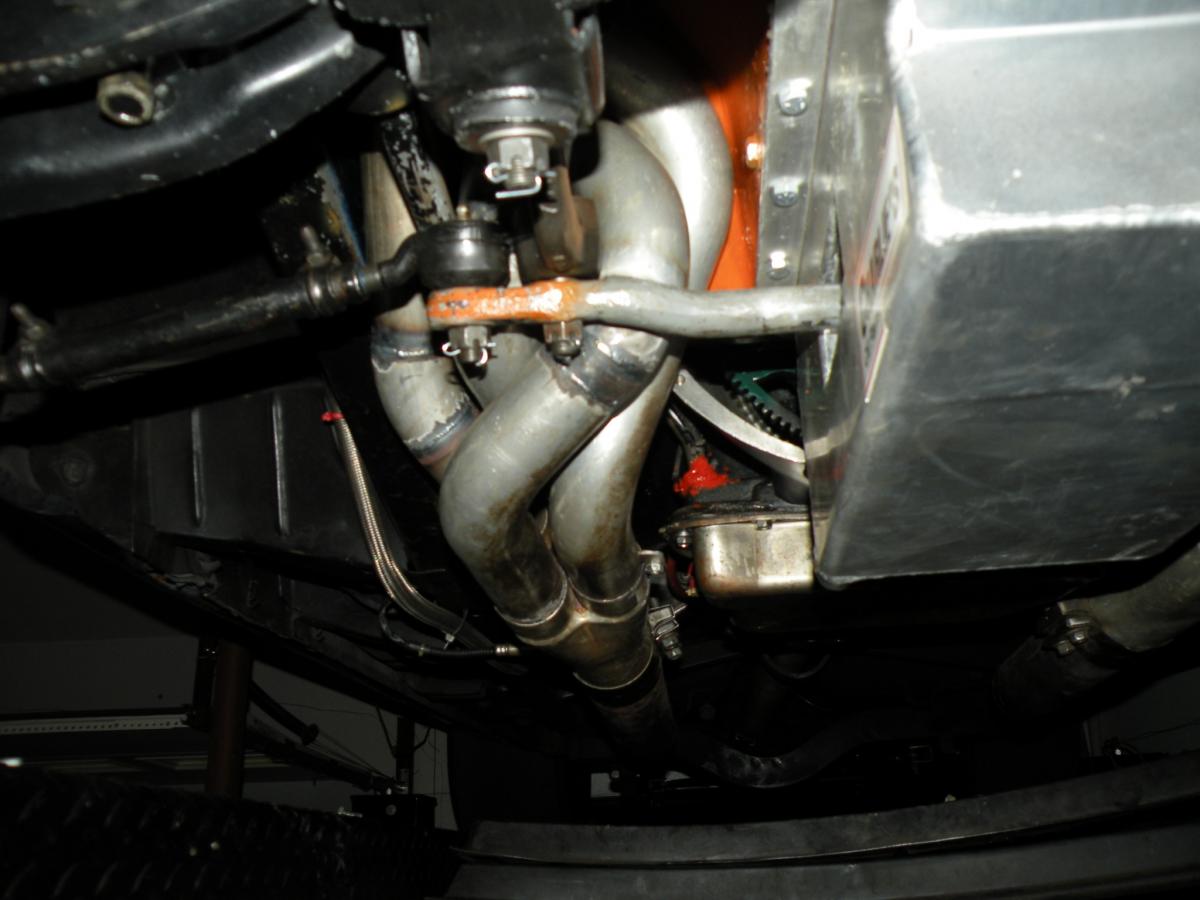

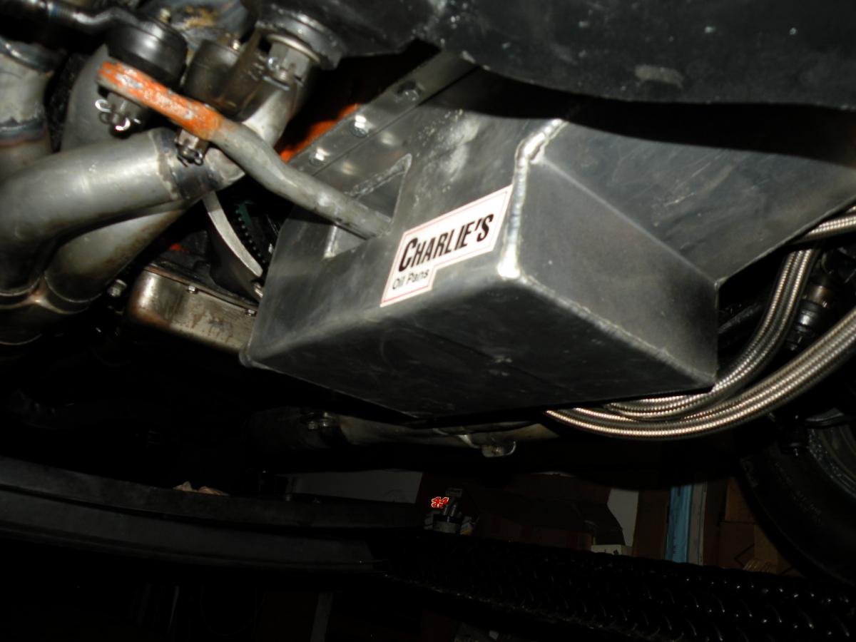

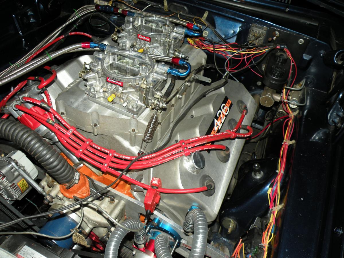

heres a few more. passenger side shock tower is so close to the new cast aluminum hemi valve covers.
nice new charlies oil pan

after the season is over. im going to get the headers receramic coated.

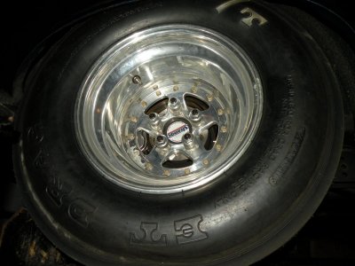

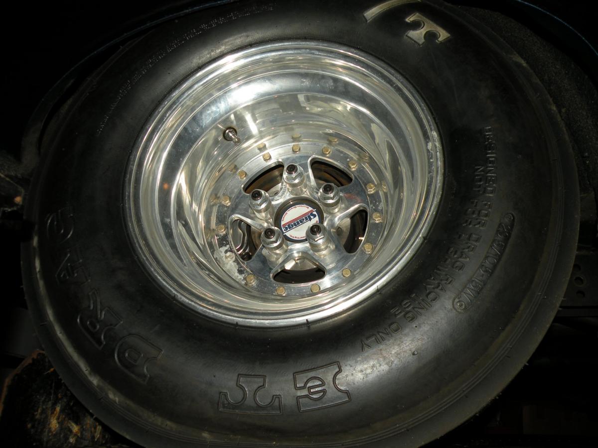

new front and rear wheels & tires too. i went shorter also.

Did you invert the shock tower on the right side already or are those covers just monsters?

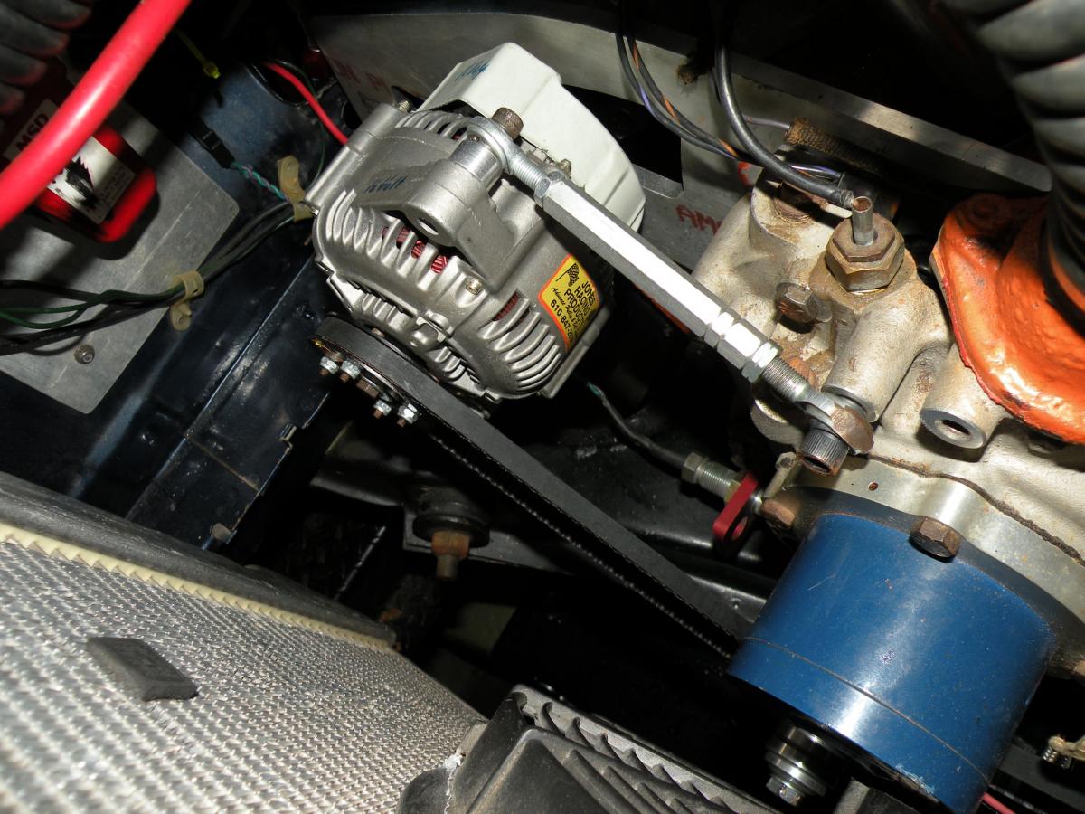

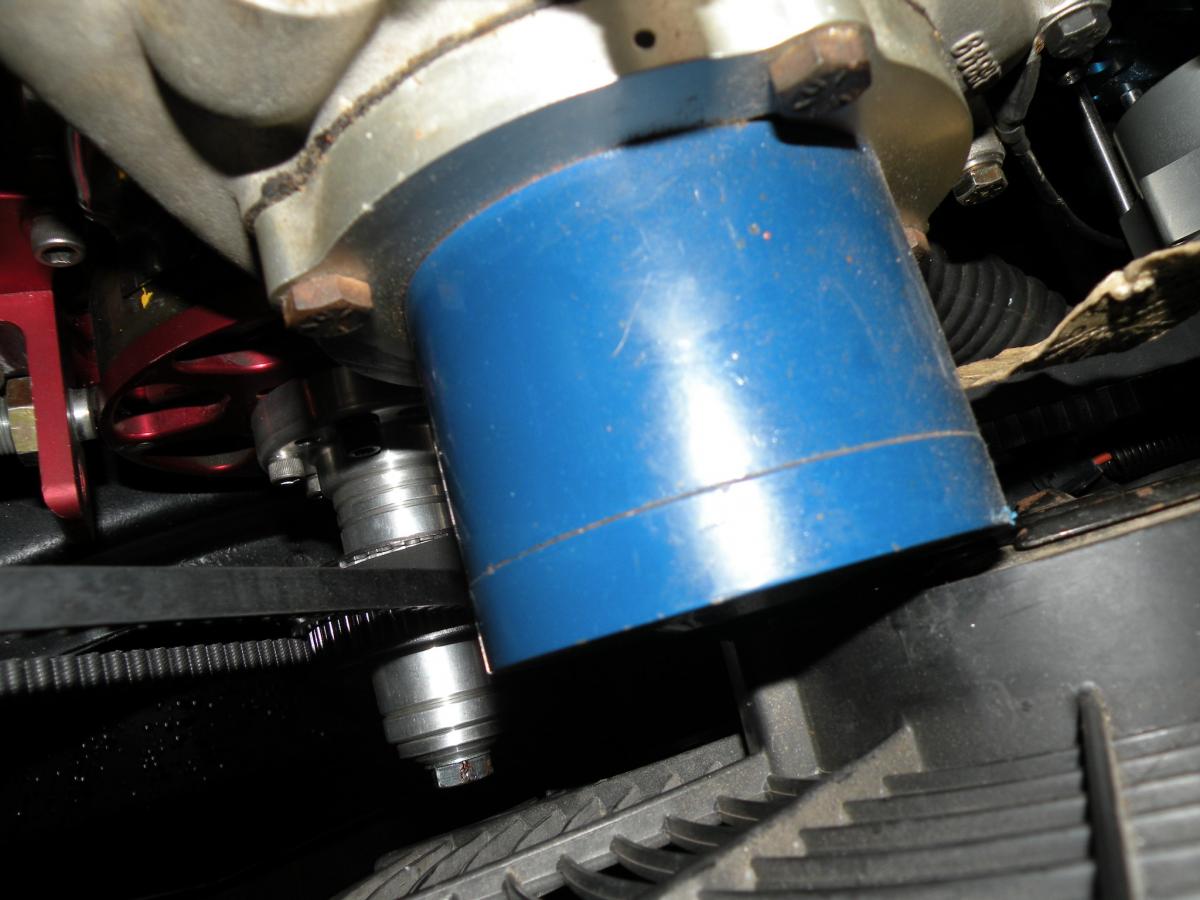

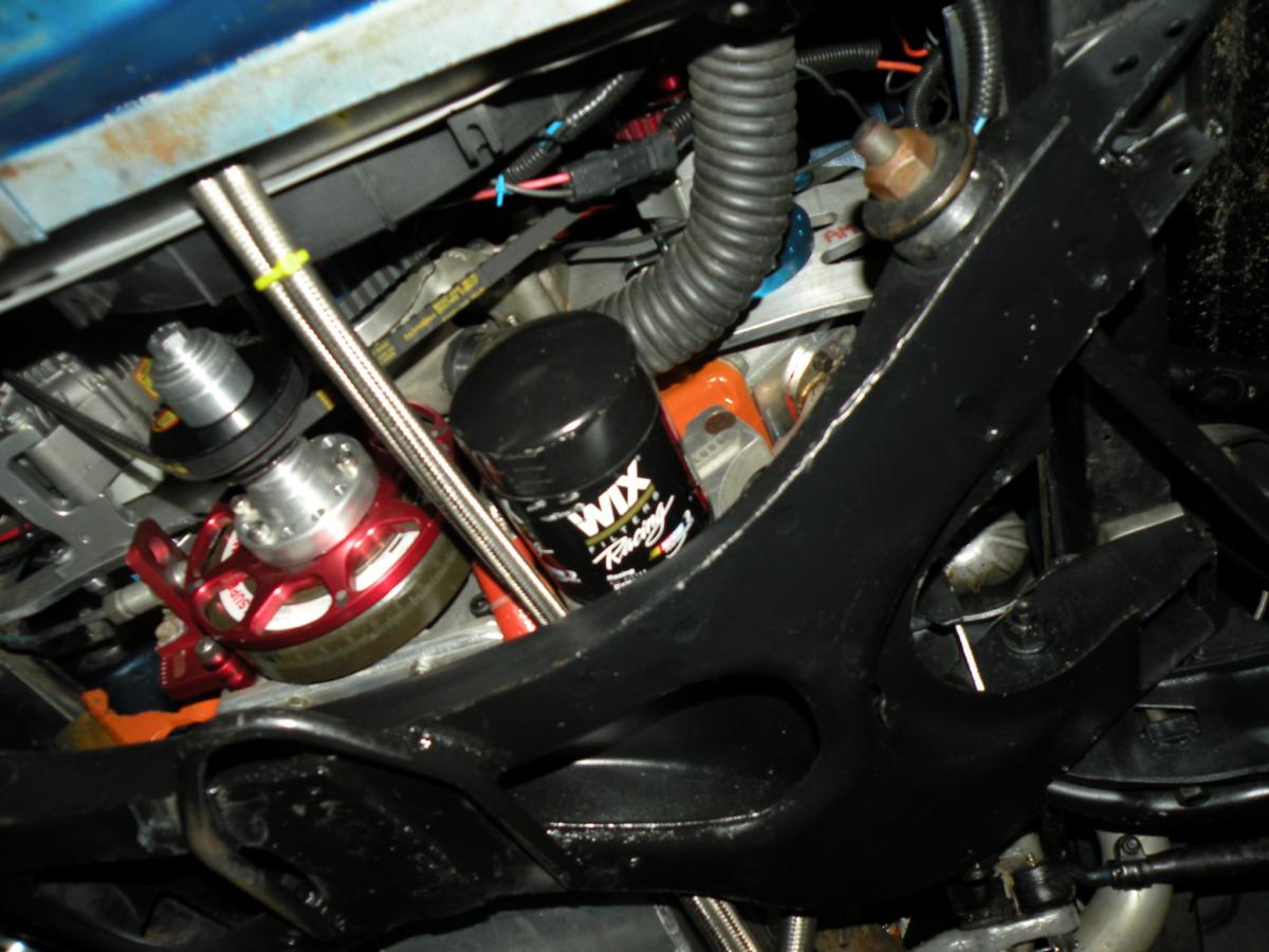

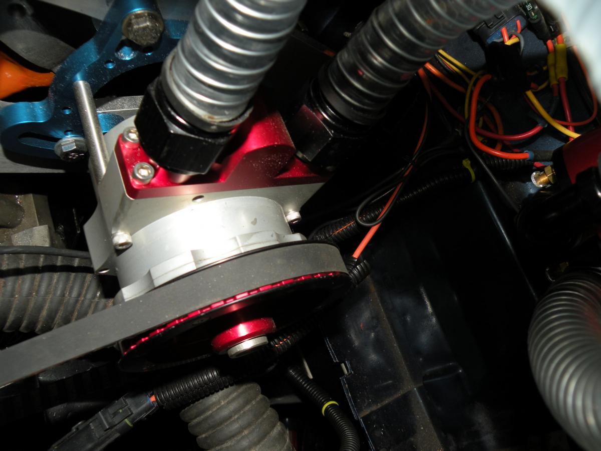

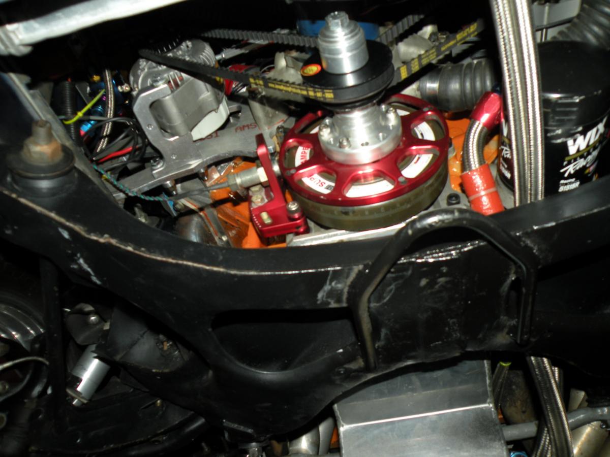

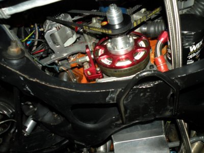

Looks Great. Could you offer more info on your crankshaft pulley... Great Idea with the heim joint used on the alternator adjuster...
Nice install SSR, sweet Hemi
Wow, Thats all can say.That is one sweet looking motor.Now I want one.Looks good chris.I want to see your numbers.
its a mandrel drive, set up for htd belt for the alternator and a gilmer pulley setup for the vacuum pump. you use it so you can space out different pulleys for alignment.
the alternator setup is by jones. its a motorplate setup with adjustable heim ends. very trick imo and easy to adjust.

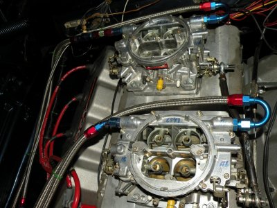

just swapped out the afcos to strange double adjustables today.
the knob on the afcos interferred with the massive idby cast valve covers. the strange worked out great as both extention and compression knobs are on the bottom.
Mark, i got the extention set very stiff for 1st pass. then will go softer each pass till i get it where i want for maximum 60 foots.

no ironside, never inverted it, i should have done it last winter while i was waiting for the motor to come back. this winter ill do it.
these indy covers are thick as hell. there is like no room compared to my old direct connection chrome ones.
