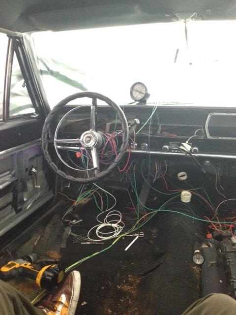

finished rewire of 67 Hellvedere, rebuilt cluster and new harness.

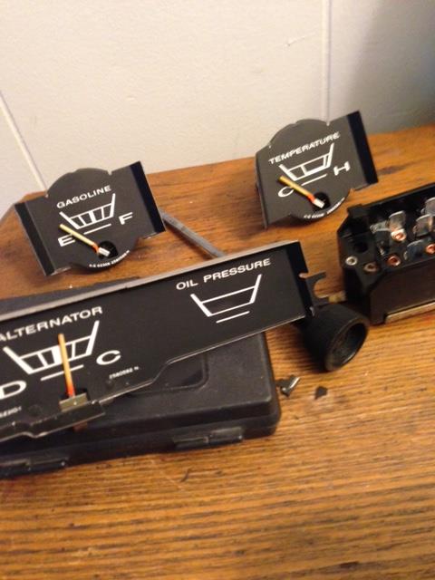

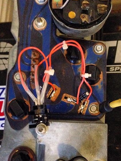

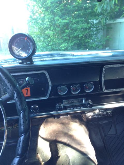

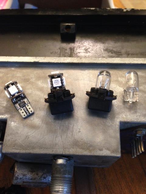

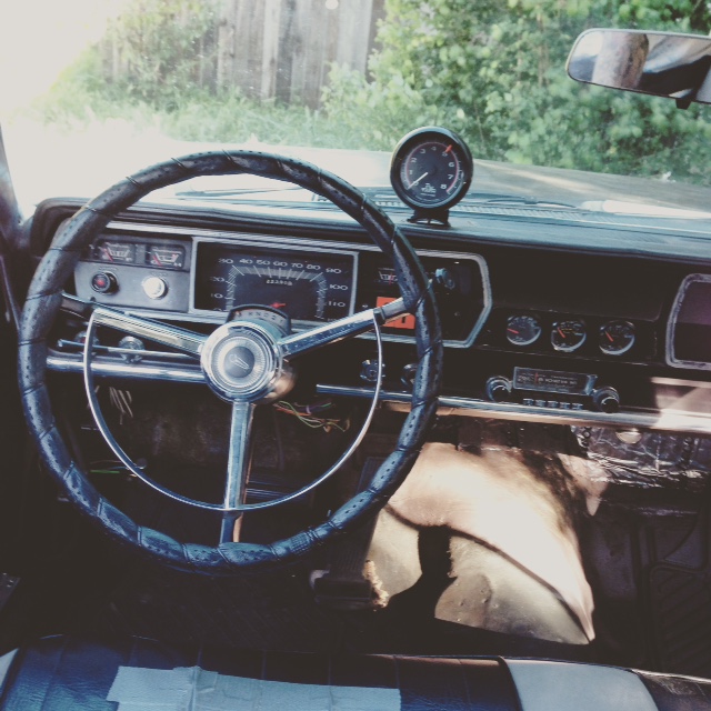

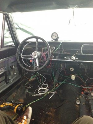

Finally stopped raining and was able to finish installing new wire harness from nose to tail. Feels good watching your volt meter not flicker around! Also since I wanted to keep my stock cluster, I am pretty excited about the re wire I did with new capacitor and voltage regulator. handles up to 50 volts, and puts out 5 volts no matter what. Also found some LED replacement bulbs that work with the dimmer. First time the gas and temp gauge has ever worked on my car. Did it all with a broken wrist too!
some more

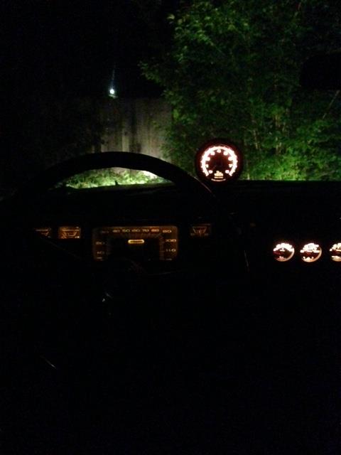

here is a night shot of the amber LED's. wish they were brighter, but still awesome.
