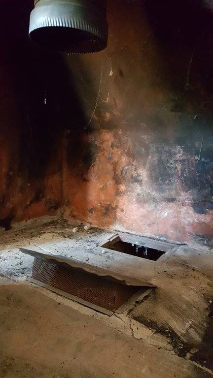

I pulled the damn thing out and i think the vent was for the original fp before the insert. Probably not needed now?

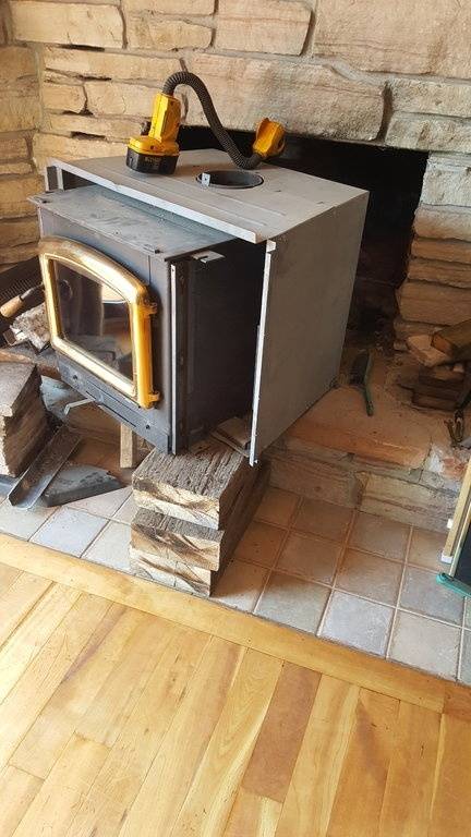

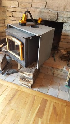

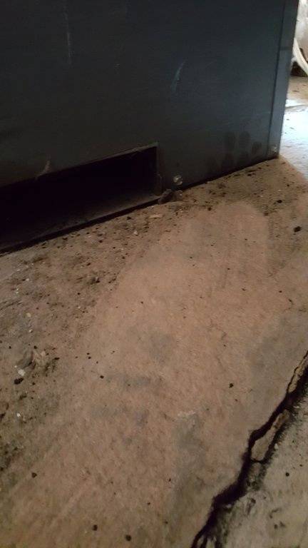

After pulling the insert out, I found that the air intake is drawn from the rear of the insert, which pulls air from below and around the insert. The fresh air intake looks like it was for the fireplace before the insert was installed if that makes sense. It is a hinged cover and is rigidly screened when pulled up. I wonder if this is supposed to stay upright as it close to behind the intake opening or slightly underneath. The combustion air then travels past a flap, controlled by the high/low flame lever, into a vertical rectangular pipe inside the firebox, which connects to the baffle. The insulation just sits on top of the baffle and really just filters the smoke I guess before it enters the flue.
