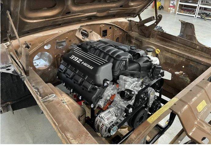

Hello everyone! This will be my first post since joining the group back in ‘21. I’ve benefited immensely from being a member while working on my old ‘72 charger (which has gone on to a new home) and gathering parts for my new project, a ‘69 charger that is currently getting a 6.4 hemi swap with tr6060. Most issues I’ve been able to resolve so far but I do have one currently that has me pausing before I continue on.

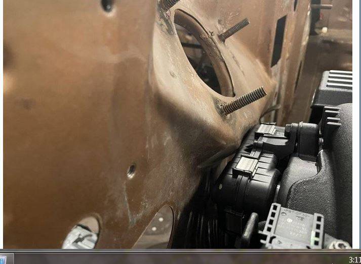

For those who have used the QA1 k member (torsion bar delete and rack and pinion steering option), was it necessary to clearance the firewall just under the wiper motor mounting point? The hemi has a small electronic box (I’m assuming it’s air mixture related) that is not allowing me to position the engine as it’s hitting just under the wiper motor bulge on the firewall. Before I cut to clearance, I was hoping someone had experience here…..I don’t want to cut the firewall if there is another workaround. Oh, I have all the washers on the motor mounts stacked at the rear so the engine sits as far forward as possible on the mounts.

Not sure but you are probably dealing with the MAP sensor. I don't have any help for you but I had a similar issue with installing a 6.1 in my Charger. The MAP sensor was not a problem and mine is different from yours but I remember the vacuum port had to be altered some because of firewall clearance. Hopefully someone that has dealt with the 6.4 will have some input.
The thread The Roach 1970 Charger had to cut firewall in that area. Search "The Roach" Did it for you. The Roach

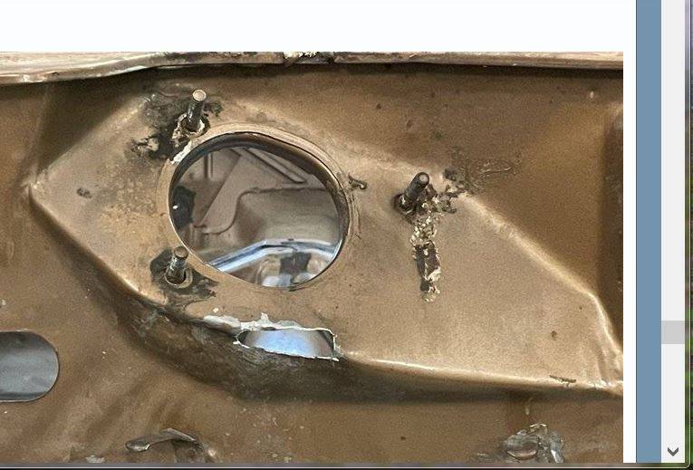

I’m going to open it up a bit and see if I can get just enough clearance. Apparently the offending bulk is a Short Runner Valve (SVR) only used on 6.4L according to Mopar. It has a connector built into the new harness so it’s gotta stay.
Thanks for the great pics sixpactogo!

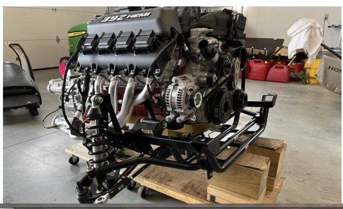

Here’s mine!
Wonder if the QA1 torsion bar frame has the same issue? I’m considering the swap. Maybe a 1x4 or 2x4 intake might fit.

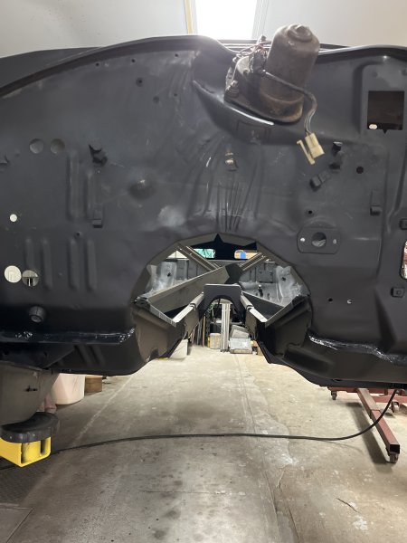

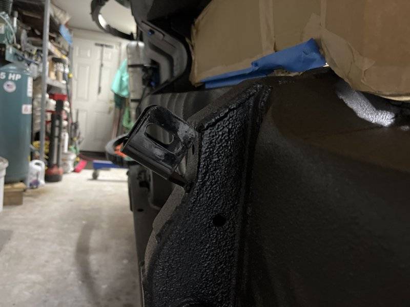

Spent the weekend making the clearance needed for the SVR and final welded all the brackets and USCT tunnel support. I also mocked up the SST clutch master and took measurements to have a SS braided hose made for the clutch. Next up is coating the undercarriage with Raptor liner then running some fuel and brake lines. Now it’s getting good
