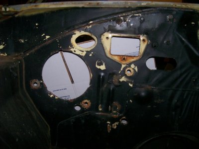

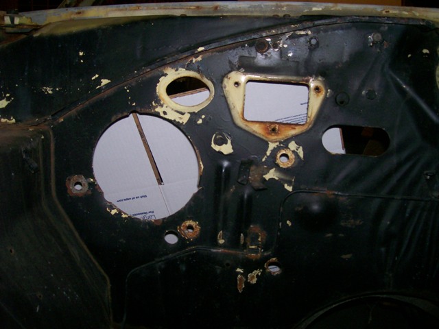

Here is my situation. My 69 sport satellite was an A/C car. I am not going to have A/C when its done. I have a heater set up for a non A/C car. None of the A/C equipment was with the car when I bought it. My dilemma is what to do with the firewall. Should I find an A/C blower motor/heater and just not hook up the A/C stuff, weld in half of a non A/C firewall or fabricate some sort of block off plate in case I ever change my mind about having A/C. If you have done any of the above let me know pics would be great.
With what you describe i think i would fab a nice looking plate to put on, just in case you change your mind down the road.. A pic of the firewall and the opening you need to do something with would help guys help you in deciding.

My thought would be to fab a nice cover plate. If you ever decided to put the A/C back in later, make life a lot easier. And if you ever decided to sell the car, A/c would appeal to a lot more people. JMHO
Block off plate 100%. I just did a number of plates on my firewall, including a large one for the bulkhead connector. I just tacked them in and ground back the welds. I am going to have my body guy level it out. But, they are easily removed and cleaned up if I want to put the car back.
You could fab up a nice cover for the large hole left by the A/C. One out of sheet metal painted to match the car or a nice cover out of stainless steel. If you think you will never change your mind, then you could weld in a pc. of metal to fit, grind smooth and paint. My car was factory A/C and I welded the hole shut and painted to match. One or maybe both, can't remember , of the heater hoses will go thru the plate that you fab but is easily drilled to fit.
I think I am going to go with grafting in a piece of non A/C firewall. Like it has been stated with a block off plate I would have to drill an additional hole in the firewall as the heater core doesn't line up with any of the existing holes. firewall.JPG
