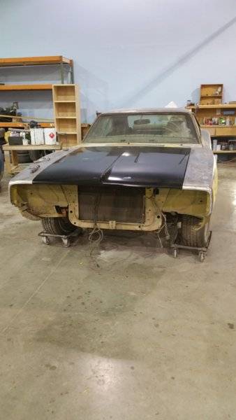

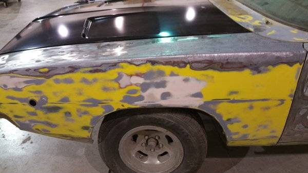

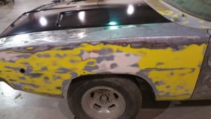

Stopped by the shop yesterday, more good progress. They have all the old trunk out and frame rails sealed up. I was surprised how nice they were, no rot or accident damage.
He drilled all the spot welds on all the old panels, must have taken a while!
Been there done that, lots of work!

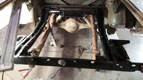

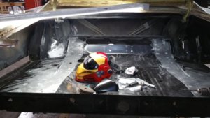

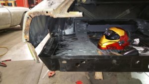

Stopped by the shop again last week and dropped off the restored taillights and picked up my grill. The trunk floor is almost done, the back should be done in a couple weeks. The workmanship is amazing.
There are a ton of spot welds back there!
