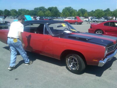

Hello all!
So I know very little about muscle cars, especially Mopars. Went to an auction with father-in-law yesterday hoping to get a Chevelle, ended up with this ride instead. '69 roadrunner, 38 thousand orig. miles, 383 with Edelbrock (I am assuming aftermarket) carb and intake, mechanical ignition, Dana rear end. Auto tranny, bucket seats. I hope this is a good car as I know VERY little about them. Oh, it does still have original "meep meep" horn.... :)
Ok, list of questions if you all would be kind enough to help:
1) - Steering. Tracks straight at 80 on interstate, but steering is loose, especially turning to the right. Should I look into steering gearbox first? It is power steering. Just want to tighten it. Also, steering wheel is turned about 90 degrees counterclockwise while driving straight. Is this an indicator that steering linkage is off key, or can I just take wheel off and straighten it?
2) - When cold, this thing fires right up. Never misses a beat. Idles at 550rpm. When we run it for a while and turn it off, it is hard to start. Also noticed that when we shut it off, the clear fuel filter (to left of carb) drains completely empty. Weird. Any ideas? We can pump the pedal and get it started, rev it good and it runs perfect again.
3) - The bucket seat brackets have little pieces of what looks like 2x4s painted black that actually bolt to the floor. Were these put in by someone to help lift seats, or to replace a part? If so, where can I but new parts? The bracket under sliding rail is there, this is just a 2" wood block between rails and floor pan.
4) - Anything special we should look out for on this motor? It seems to run real strong and no smoke. Really just curious about common problems to watch for or easy upgrades, mostly for reliability.
5) - How easy is it to make this thing have power brakes? Is there a kit that is easy?
6) - Regular unleaded ok to run, try to find no ethenol I assume?
7) - Very clean and intake interior and exterior, want to replace some worn-out parts with oem or oem replicas. Where should I look? Primarily the rear view mirror (worn out and won't hold position well), wiper blades and arms (want close to original), and screws to hold side-view mirror, they are stripped out.
8) - The headlights are halogen, but they have some half-light covers over the lenses. Some sort of chrome or painted metal. Were they from factory or added cause someone liked them? They just cover the top half of lights. What is purpose??
Thanks all! I am trying to learn as much about this car as possible. Been spending lots of time today on Wiki and google. Hopefully you can help out with a few of these questions.
