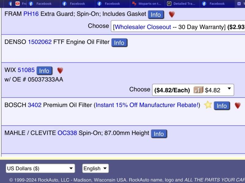

We used to install the angle adapter on small blocks with headers, a common practice back then. Or, use a shorter filter. You can cross-reference to get a better filter. A Mopar MO-090, or a K&N 2004.
Everyone makes a short filter
51085 WIX is short
I use a 1068 or 51068 WIX....same same as far as numbers go and that's without the angle adapter. Have to use that one on 1st gen Dakota but you might look up what a 1st gen Dakota is supposed to use because it's even smaller. I always use the largest one possible on my junk. The Dakota came with one that was pretty short and smaller diameter.
Compare a oil filter for a Chrysler PT Cruiser Turbo. Short with a thinner body.
Numbers like K&N SO-2009 Napa Gold 7356 STP S3600XL Many others.
I have been using these on all of my Mopars for well over 20 years.
The Turbo models have a thicker case Plenty room on my LA318 with headers.
Damn if I could find the Wix number
The filters I mentioned, are about 4" height, as well as the Wix 51085. The K&N 2009 filters are about 5" height. ( the filter you pulled x-refs to the 51085 sizes )
