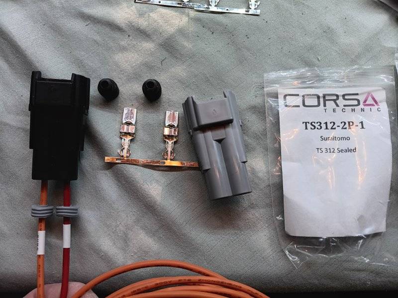

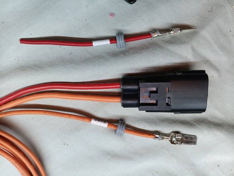

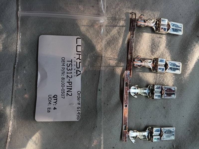

In case anyone else is using/considering a FiTech setup and needs larger guage wires to reach the distance. I found the connector/contacts if you dont want to change to another or splice. Here is a link, also has the tech information listed as well. Hope this helps someone. A few pictures for reference.
- Sumitomo | TS312-PIN2 - Corsa Technic | TS 312 Sealed Series Pin Contact
