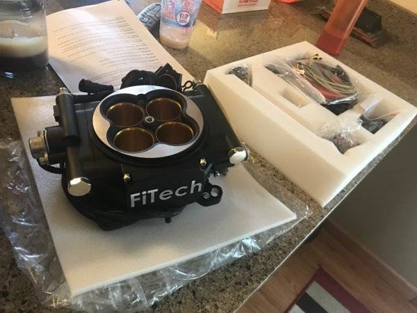

Sniper is basically the same thing, except their unit is limited to 600hp for now, their 8 injector version is supposedly coming out this spring/summer. Terminator is not self learning I don’t think, but fully programmable with custom fuel tables etc. I went with the fitech 1200 unit it’s self learning or programmable, not ran yet so can’t teally speak on it, but I would not run a fuel command center if you decide
To go fitech, a lot of problems.

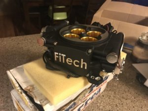

I've run 2 FiTech units on my crossram for over a year. The folks who are going to have trouble with it are the same folks who have trouble with carburetors. I just saw a post from a member who was looking for suggestions for a bolt-on and go carburetor. They don't exist...unless you're willing to live with a bad tune.
If you enjoy working on your car and are willing to do some research and READ directions, you probably will be okay. FiTech's tech service is getting much better as they catch up with the demand for their product.
dart4forte; If you search this site, FABO and FiTech's site, you will get an idea what's involved from people who have actually installed and used the system. There is a lot of useless repeating of bad information from people who have never opened a hood, let alone worked on an engine. JMO
