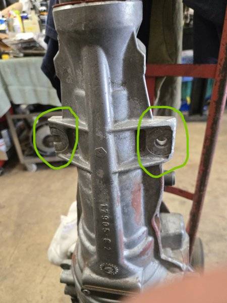

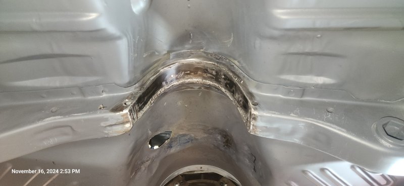

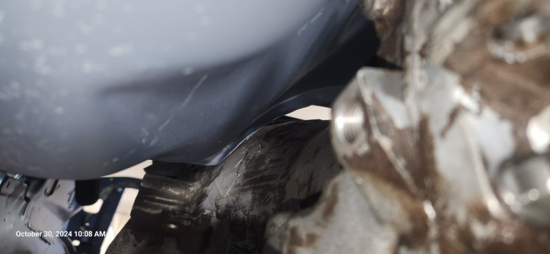

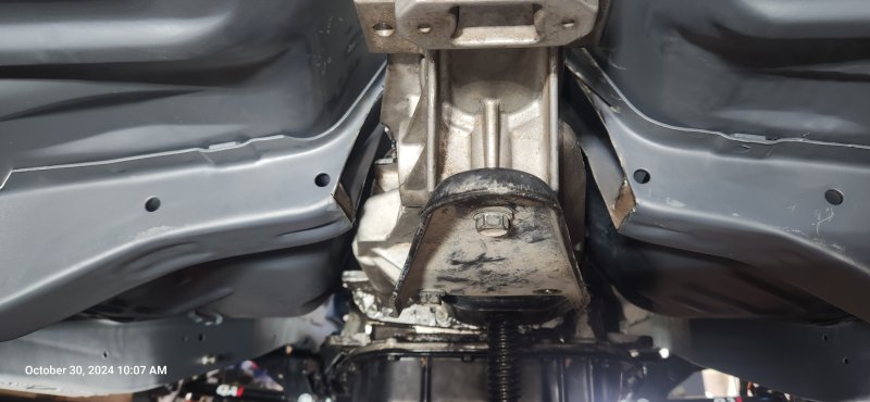

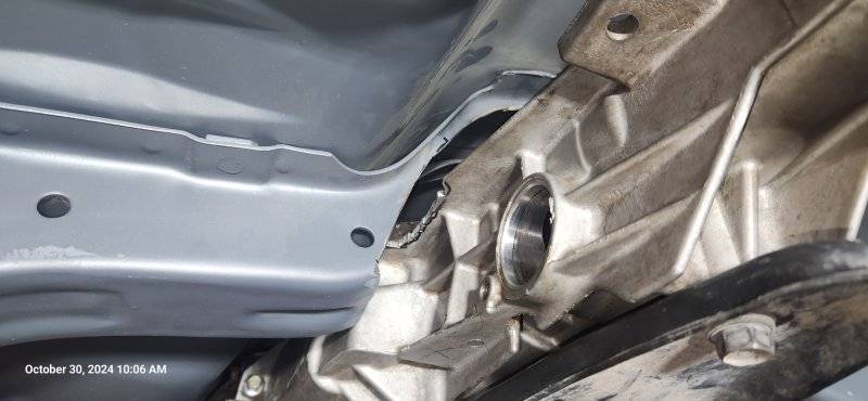

72 B body is the same floor pan basically as an E body... It should fit with minimal problems... Trim the transmission case and leave the car body as is.... The fixturing tabs on the O/D need to be removed, the webbing near the speedometer has to be removed.. Driveshaft will need to be cut.. Shift linkage & kickdown linkage should bolt right up....
Excellent info, thanks! I have semi-capable fab skill but would probably get the USCT unit for simplicity's sake.

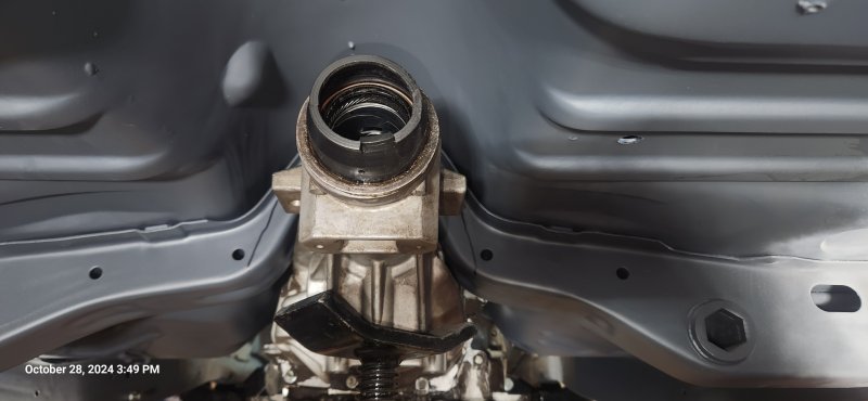

I'm thinking the 42 is about 1/2" shorter than the 46... The speedometer cable is ridiculously close with the 46... You might need to use a gps speedo or get really creative to run the cable..
