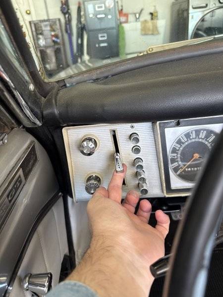

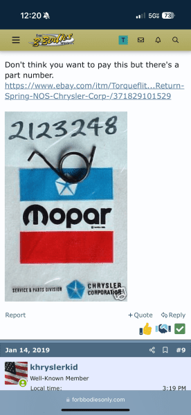

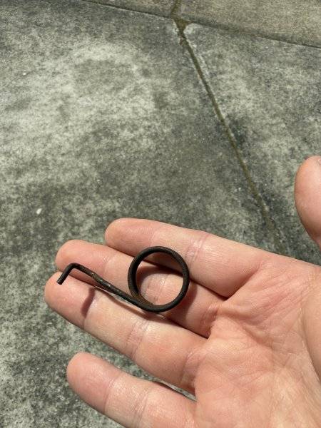

Spring broke off the parking lever, popped a new one in and it works like a dream again. Thanks for everyone’s help.
My question now is, how do I best ensure this doesn’t happen again for the foreseeable future? I’ve read someone where people always apply the hand brake before lowering the park lever and parking the vehicle to alleviate the pressure placed upon the spring I broke.

If the original spring lasted 60+ years your new one might last that long. No preventive measures to make it last any longer. Applying the parking brake before placing it in park can take pressure off the park gear but not the leavers spring.
