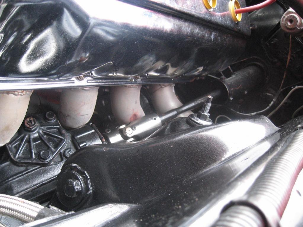

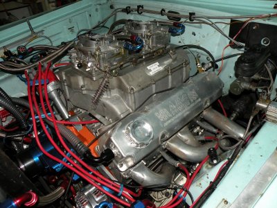

yes. thats the one. i use the FRiver coupler with built in shaft but i have that one going on my hemi belvedere 65.
not the greatest pics but you get the idea.

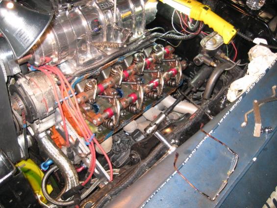

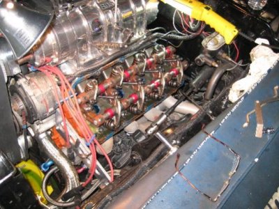

Here is a picture where you can see the coupler:bootyshake:

I went for the "bling"! There are many cheaper ones but they don't seem as stout:munky2:
Nice setup, but is there a lot of vibration transmitted up to the steering wheel?
If you have excessive vibration,there's a problem elsewhere.The engine is solid mounted also.
