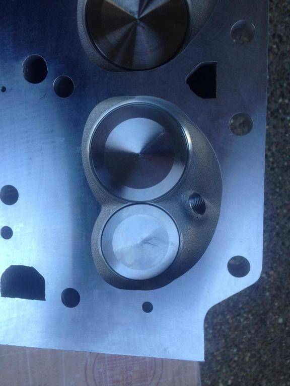

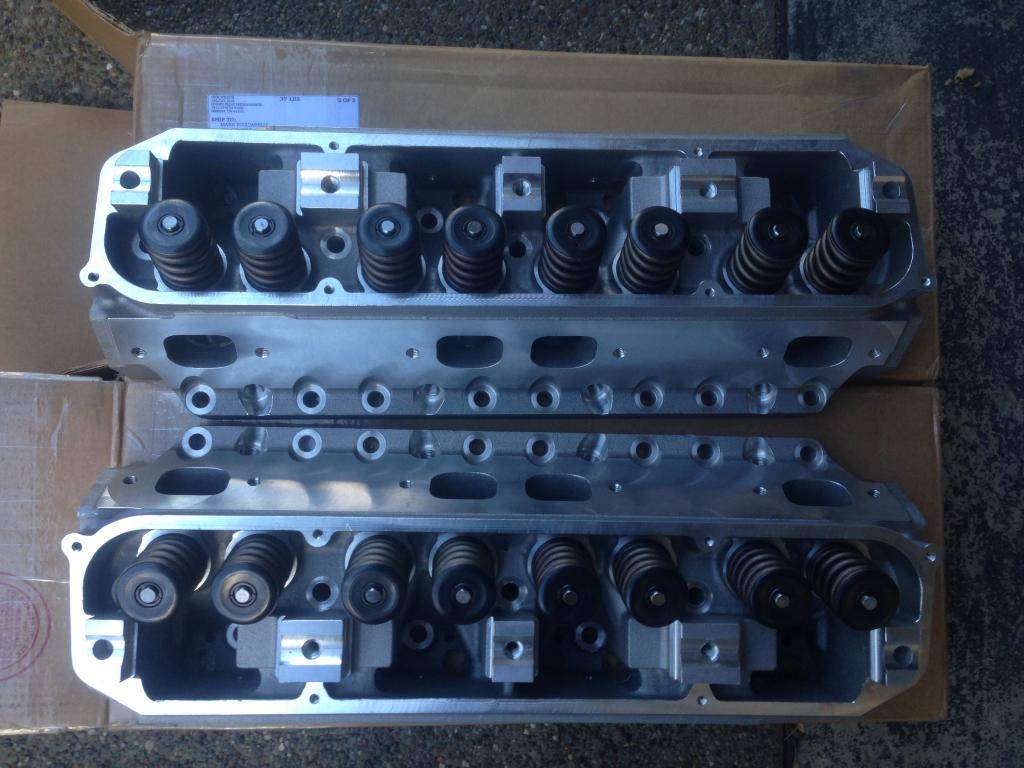

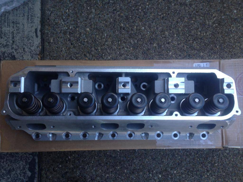

A few pictures of the Indy EZ heads with stage II porting.
maybe a photo looking down the ports intake & exhaust,
showing the business side of where/how it works/ported,
I'd be curious to see the pockets under the valves too, see what they actually have done
nice Indy EZ heads I'm sure thou

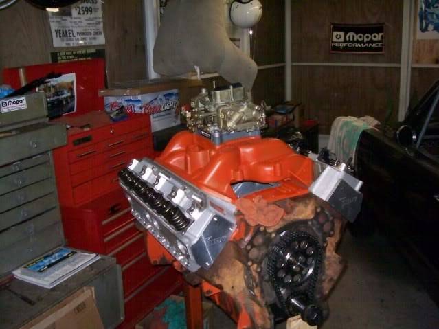

You know I never took any good pics of my EZ heads when I built my eng. I do remember that I bought my EZ heads from Dwayne Porter and he just opened up the end of the ports to maxie size and we blended the bowls as thats about all he did to them. I remember they did flow 329 @ .600 on the intakes and about 229 on the exh. Here is a pic of the eng as I was building it. Ron

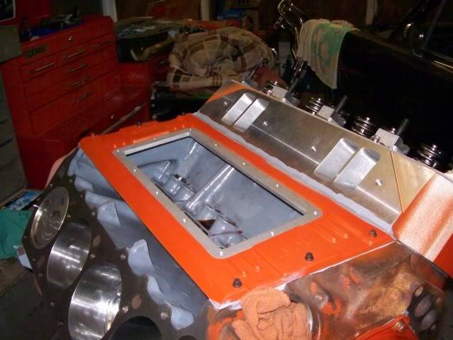

Ah I did find this pic I forgot about. You can see the intake ports some and sorta see the D-dish pistons I used to keep my comp at 10.6 as it would have been to high with flattop pistons which I had at first. I had flattop pistons because I was going to use the 84cc Eddy RPM heads but changed to the 75 CC EZ heads and had to change my pistons then so I could still have quench and stay pump gas friendly. It worked good as I traded the flattop pistons to my brother for his 1 year old Hughes 1.6 roller rockers and shafts. Course I had to buy the new dish pistons. Ron

By the way thats my old 906 headed 440 eng as its one of the only pics I have of the 850 with no air cleaner on it. As this is the 493 with the EZ heads. Ron
