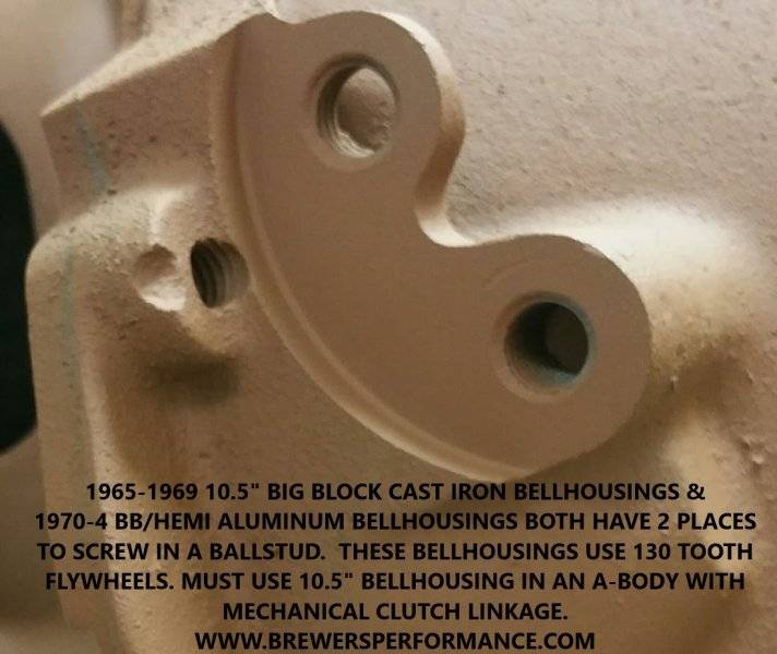

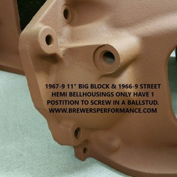

10.5" BB bells for 130 T flywheel have 2 or more bolt holes for the clutch linkage ball pivots, 11.0" bells for 143 T flywheel have only one.

70 B would have had an aluminum 10.5" bellhousing originally....so it has been changed. Cast iron bell could be 10.5" or 11.0".....does it have one place to screw a ballstud into the side or 2? Or count the teeth on the flywheel like others have mentioned.
