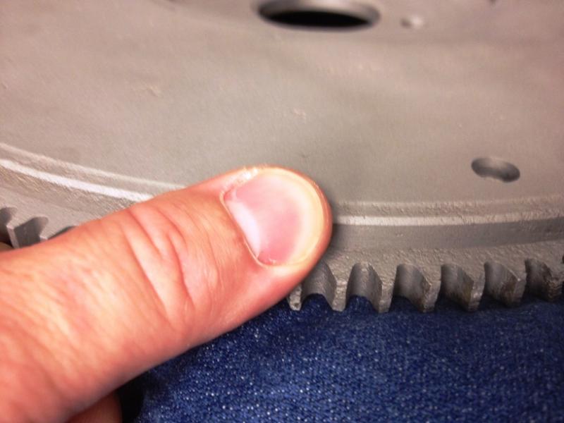

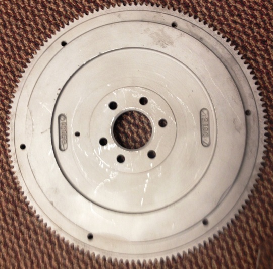

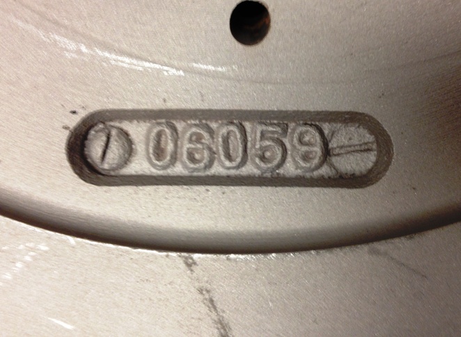

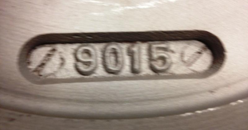

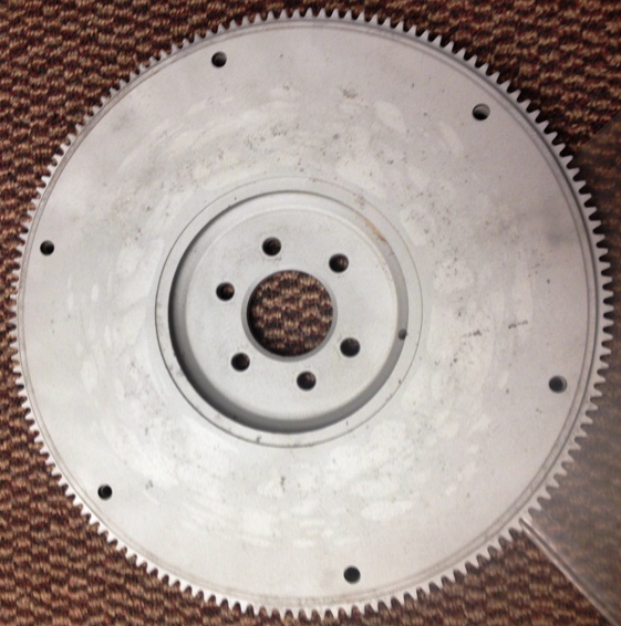

Gents, I have what came out of a 1968 D200 2wd 383 with a 4 speed quad cab truck.
The numbers on the flywheel are 9015 on one side and 06059 on the other. Is this trully out of the 68? The 06059 makes me wonder if it isn't older.
Once I am sure what it is I will repost is the forsale section as I don't need it. I just know where I got it. The sad part is I went to check on the truck and it had been crushed. I wish I would have purchased the whole thing instead of just the motor and tranny.

Looks like a regular internally balanced BB flywheel to me. Could use a new ring gear, and a fresh grind. Measure the marks where the friction disc diameter is to see if it is a 10.5" or 11" clutch.
