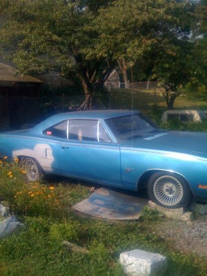

can someone please help me find out what year ths satellite is. this is the only pic. What would it thake to convert to a RR. Front clip???
Like Rev said it's a 70'. I'm not to familiar with them so i can't say for sure, but i believe the hood is different.
As 69 said - the only metal you'd need to change is the hood.
It's a 70 Satellite. Change the hood, taillights and I believe the grille and it will look like a RR! Change the rearend to an 8.75, drop in a BB, a 4 spd or 727, add swaybars, front disc brakes, big rear drum brakes and it will run and handle like a RR! Add buckets, console w/ floorshifter and a floorshift column and it will feel like a RR!
