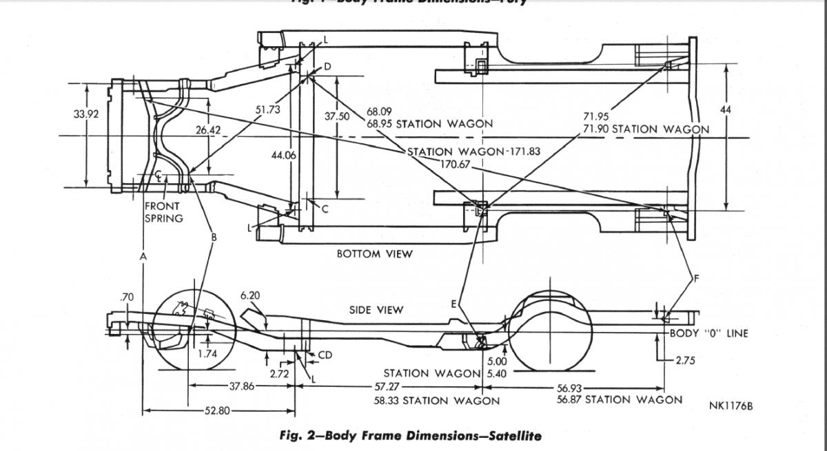

This the one you have?
Prop
I have that one but it's not precise

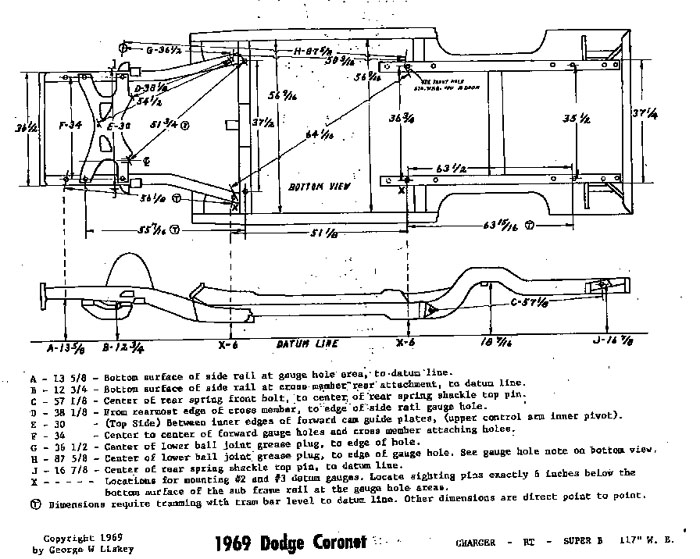

are you looking for the chart for the upper body measurements ?
