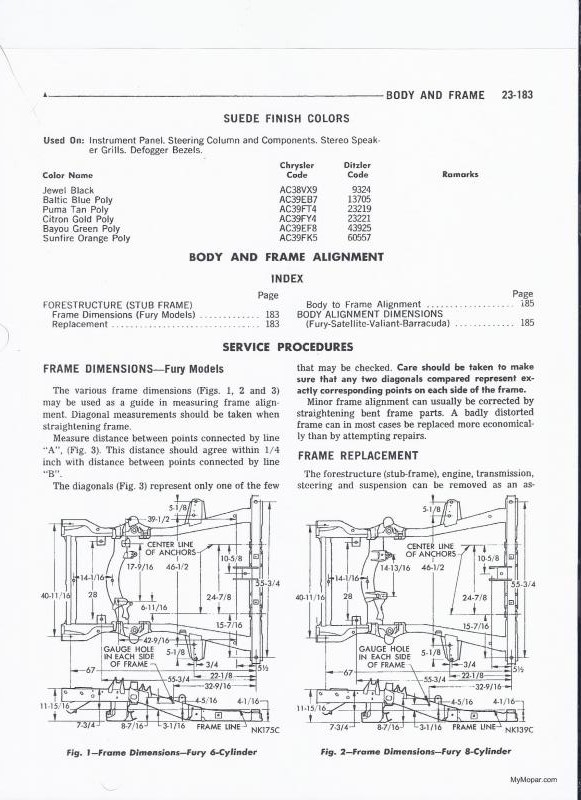

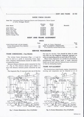

I am restoring a 1969 Roadrunner Convertible and am having a problem aligning the front fenders. Does anybody know where you can get frame measurements from?
here are the upper body measurements and your lower body measurements hope this will help you out
That is awesome.... Now I have the specs for my 69 when I put it on the jig to replace the left front frame rail .....this site never ceases to amaze me with all the informative people on here
