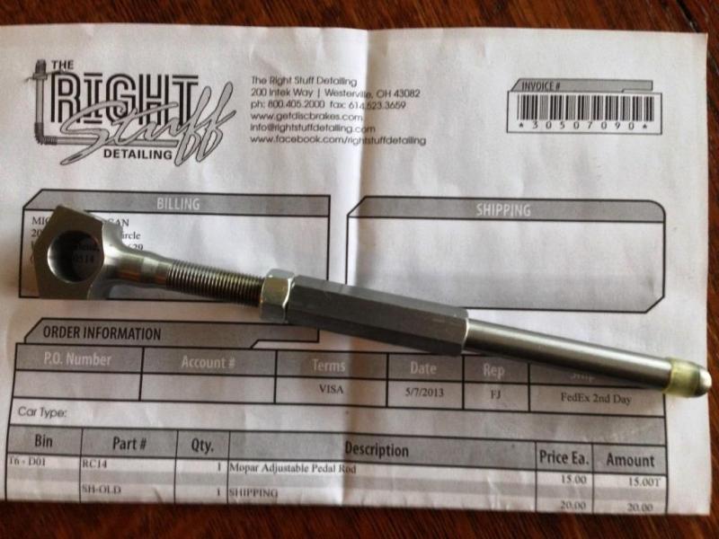

The right stuff has an adjustable pushrod for the pedal to master, and only $15...
