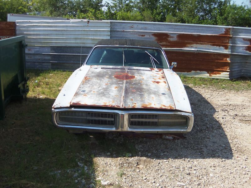

Well, I've been re-evaluating my 74 project and what I thought might be my savable parts car...and decided they are not worth both quarter panels, and cowls, plus frame repair.
I was thinking I might like to have a 72 Big block car, and one just about dropped in my lap.
72 SE Brougham WP29P2A

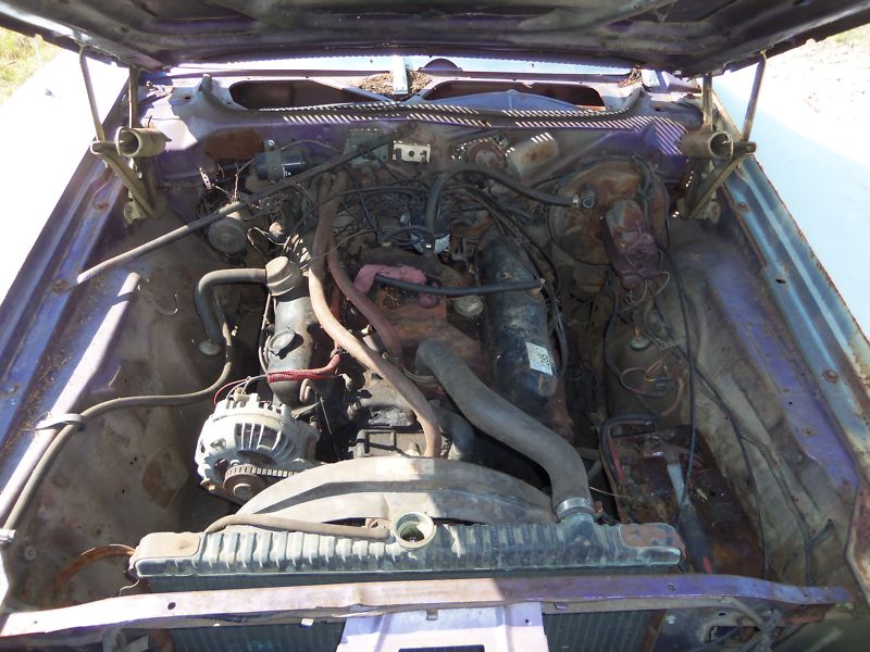

400- 4 barrel car (now has questionable small block with iron 4 bbl intake)
A/C
Hidden headlights
8 3/4 axle (don't know gear)
Front and rear sway bars

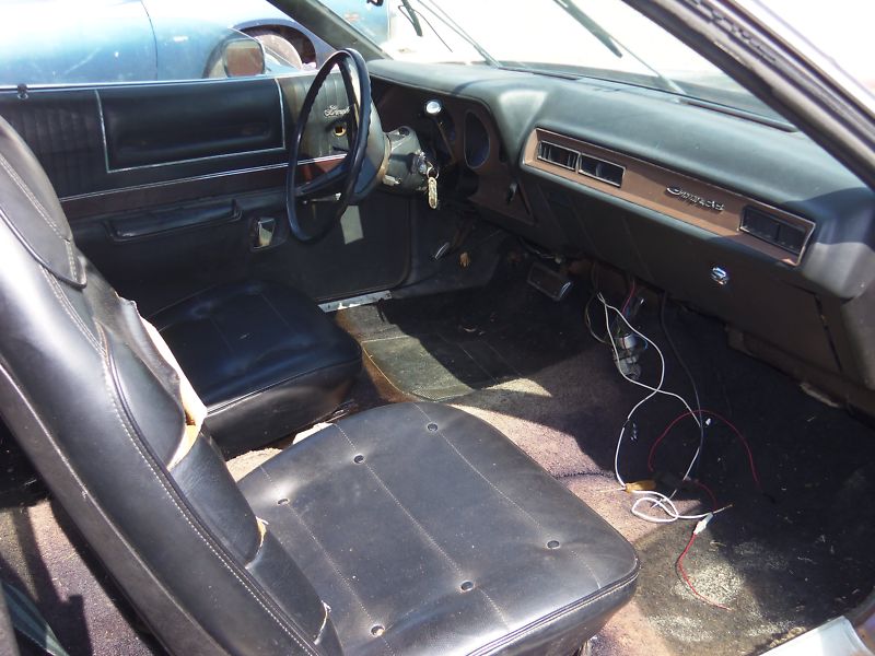

Rallye cluster with clock
Was bench, but has buckets with correct tracks
Was Dark Tan Metallic- repainted Plum Crazy (including underhood and jambs)
Was Tan interior but has been swapped to black

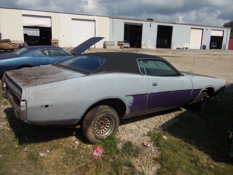

Unibody/frame rails are solid
Doors shut nice.
Cowl is solid including vent tube (minor issue on DS hinge pillar)
Quarters will need patched behind wheels

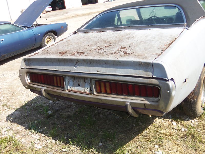

Trunk is solid
Front floors have soft spots
Deck lid is a B+
Hood is not as bad as it looks
DS fender is wasted, but "dog leg" is good (surprise)
Has 73/74 Tailights but I have a set of ralley lights (and a rallye hood)
Worst part of car is bubling rust under vinyl by drip rail and around top of windshield.
I peeled top and picked at a few spots with a screwdriver and none went through...but that don't mean it's all good.
I do have a great roof with a factory sunroof if it comes to that.
I have 90% of what this car needs and it's a Magnum big block car with handling options :):):)

I know this is gonna sound strange, but aside from being painted, wrecked, rusted, having the interior swapped out and having the engine swapped out.....it's pretty "unmolested" elsewhere.
Reading your posts and seeing the knowledge you have with these Chargers and you have 90 % of all the parts even the good stuff like the rally lights and rally hood this will be a great car! Price seems reasonable enough, I would have a hard time giving the vinyl top up though, IF you find it needs a new roof and you cant have it with a sunroof for whatever reason..
Well...it turns out this may be a parts car too :(
Under that vinyl, the roof is absolutely cooked.
...and that's why I'm not a fan of vinyl tops.
This car will need both quarters, the dutchman panel, and a roof.
I had originally thought patch panels, but it seems one quarter has already been replaced, and although most of the metal is good, the attaching points are poorly done. The roof had been bondoed over once before as well, and the second generation of moisture trapped under that vinyl was brutal.
I reeally thought it was in better shape, but I believe I can still get my money back in parts.
I did find a tag on the axle that says 3:23, but haven't checked for SG yet.
It's still a better builder than the others because the frame rails and cowl area are much better and quite solid. Puus it's got all those factory perfomance options, making it a more desireable car.
I was hoping I could swap in my running 318, or fix what appears to be a late LA 360 that's currently in there (turns over and has clean oil and water), and drive it between fixing the quarters.
