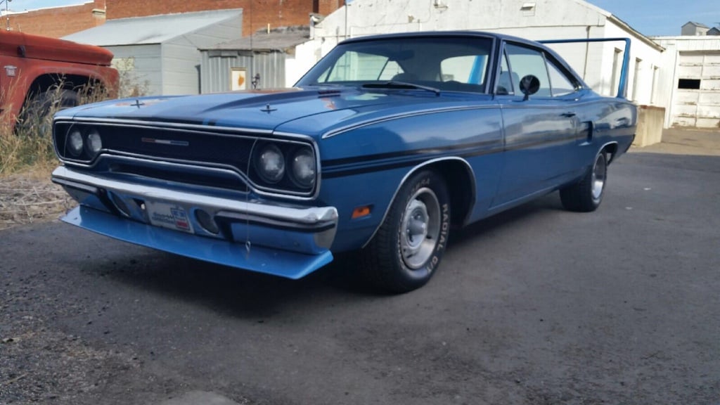

This is a guy who's on here. It's his dad's car and they made this chin spoiler from a first gen Camaro I believe.

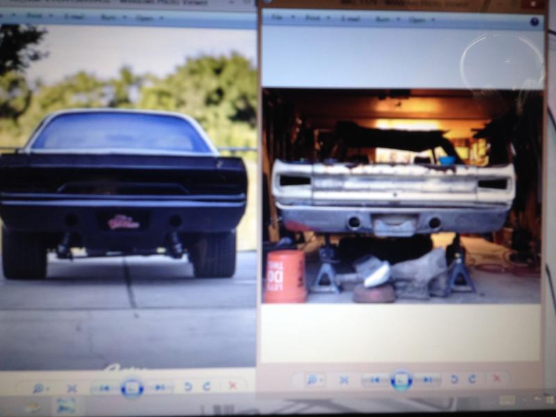

Do what I do and use the internet to look up images of both cars, ones that are staged from similar angles and distance from the camera so the bumper lengths will be close. Then save them to your picture folder and open them one at a time. Once open in your picture viewer click on the upper right to make what your looking at into a smaller window, then go back to the viewer and select the other pic and do the same thing. Then minimize the viewer and anything else besides the two pics. Click and hold on the pic you see on your screen and drag it sideways and it will reveal the second pic directly under that one. So you should end up with two smaller size pics that you can drag around to compare side by side or one above the other, and, you should still be able to use the viewer controls to make the picture subject larger/closer or smaller/ farther away to get a sense of how they compare.
Here's what I mean, this is a screen shot of my laptop screen showing two pics in separate windows of reduced size so i could compare the two pics.

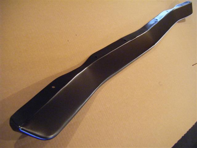

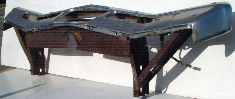

Here's the bottom of a 69 bumper
Has a lot more bends in it than the 70, which is basically straight, with a slight constant curve to the rear.
And Here's the one from Andy's (for a 69).
Gonna be hard to straighten that out enough for a 70 I think.
Agreed, looks very odd. I'd check out CDR's thread, he also used one from a Camaro but must have did something differently because it looks really good on his Charger.
Sorry to sound like a prick, but that spoiler on the Blue Plymouth looks terrible.

Thanks Aesthetikz. I'd say that pretty much rules out adapting a 69 air dam to a 70! Did you set those up there just for me? That was awfully nice of you...
