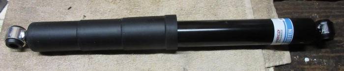

This doesn't look like a good idea. Why do the cheapie shocks I had on the front of the car have a dust boot, but the expensive Bilstein's don't? The rear Bilsteins have dust boots, albeit chintzy plastic ones. Would it be possible to move the dust boots from the old shocks over to the Bilsteins?

Hey, I've driven cars that weren't even Chargers off road! But seriously, the condition of the old front shock, which has not seen more than a few thousand miles and those on the road, suggests the dust boot is a good idea.

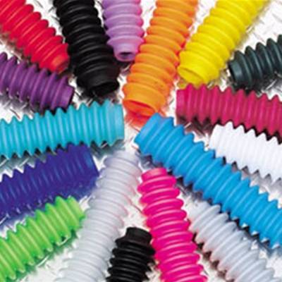

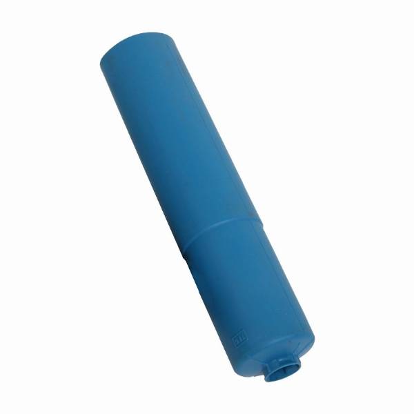

After market dust boots are available. On modern cars with strut suspensions the boots get transferred to the new struts.

If your shocks did not come with boots and you would like to add them, you can buy a universal shock boot here.
Link
The front shock is definitely not protected by anything in our cars. I'll put dust boots on mine. I can't believe a high end shock wouldn't come with them.
Bilstein did away with the boots some time ago. There are multiple seals on the shaft to keep dirt out.
As long as that chrome rod stays smooth. I imagine it will tear those seals up fast when the surface gets rough.
