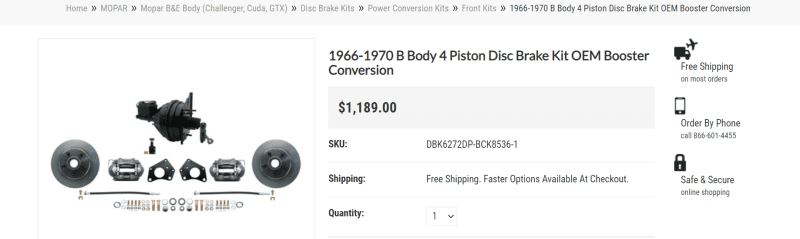

If you want to retain your stock spindles you may want to look at a company by the name of LEED Brakes. They make a kit that looks similar to the 4 piston Kelsey Hayes design found on early mopars. Here is link to their power kit

I tell people all the time to look at Pirate jack their owned by MPB which is a big importer and maker of brake parts. If you call them they make deals all the time and also they have an ebay site if saved a good amount of money with them.

I can vouch for the LEED Brakes kit through PST. I have one on my Satellite.
Good quality, great after sales support.
