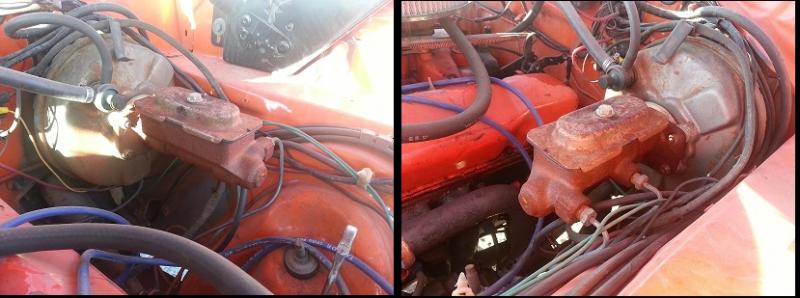

Pictures of the set up? Is the MC dual cup 1 big 1 small? or both same size?
Here is the pic of my MC.
The front brakes grab. It's basically all or nothing. The pedal barely moves before the brakes engage. If I adjust the push rod in at all, then the pedal goes almost the the floor, with no braking... and then the front brakes grab. Also - in reverse the brakes don't work well.
