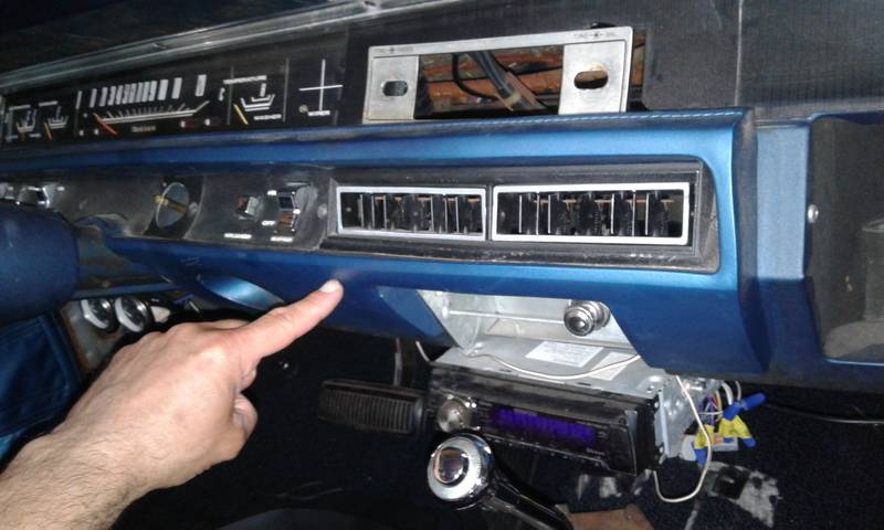

Does anyone know how to get this pad off... (it's the front pad of a '68 Coronet). I removed the screws holding the panel on for the light switch, wiper switch and speaker fade knob, but apparently there's something else holding the pad on.

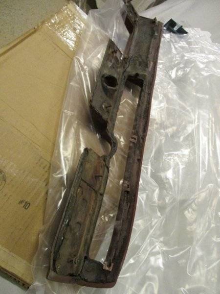

Studs w/nuts on back(?). Sorry, never touched mine.
Got out the FSM pg23-57(body-frame)
nuts on back side of dash, studs molded into pad.
