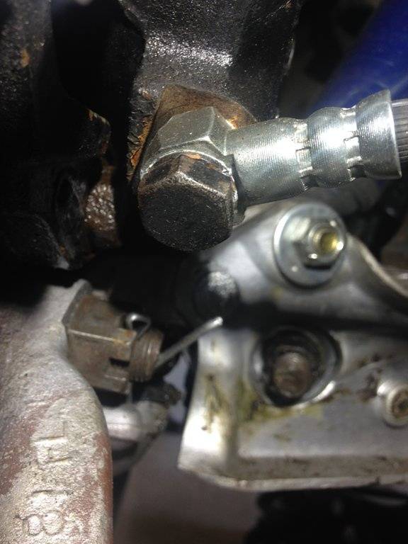

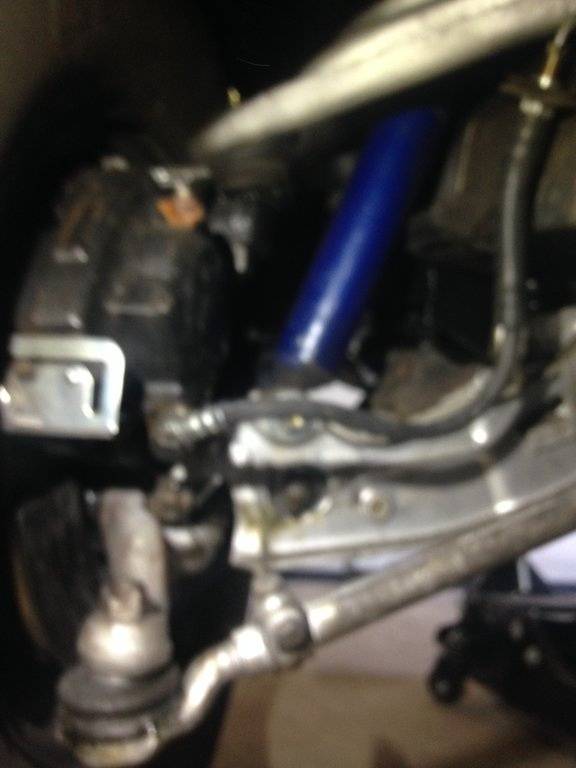

i just did the conversion to my Belvedere used the '82 diplomat master disc and rear diff wth the 11 inch brakes. for the hoses i used gm brake hoses from a camaro or something and then modified the banjo end
on the grinder and put them on . i go take a pic and post it after
i think i used
H73305 in doorman ,
