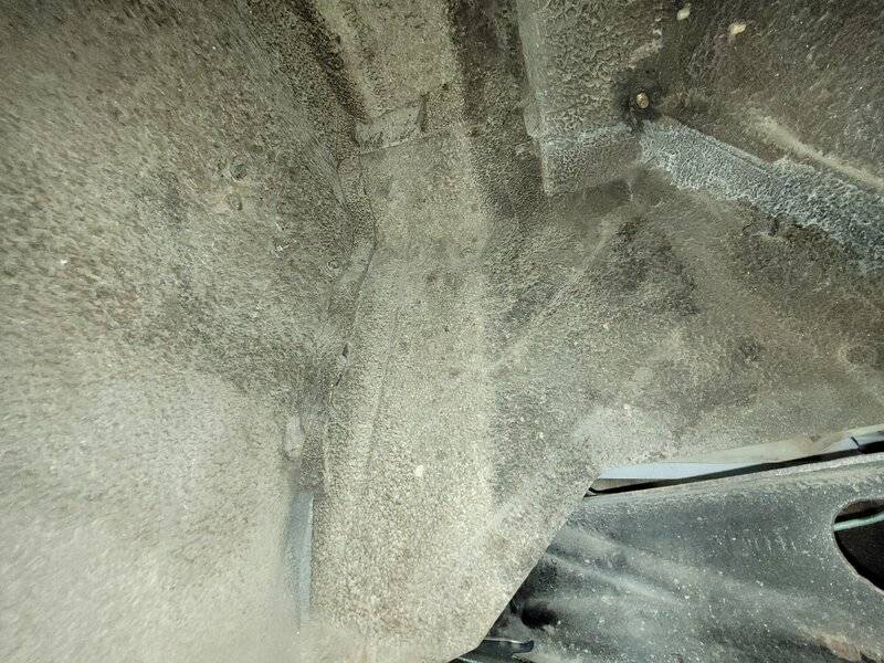

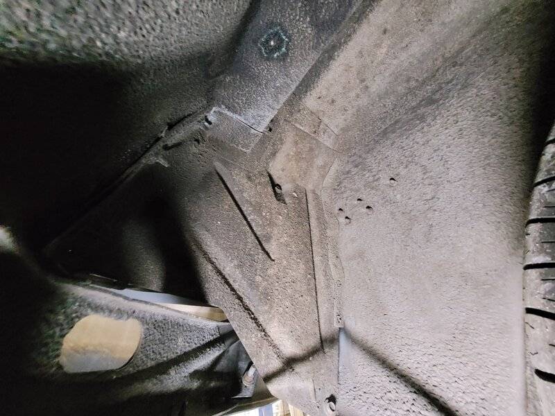

Our Dec,Jan, and Apr built 67 Chargers all had metal. April car and Dec car I know are original. I am talking about the vertical splash shields behind the headlight buckets.
If you were talking about the shields on the frame, I have only seen them as you described.

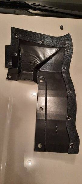

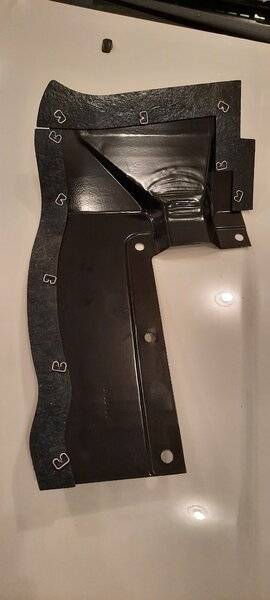

I need the ones that bolt up behind the head lights.
NOT the ones that bolt on the frame rail.

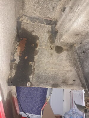

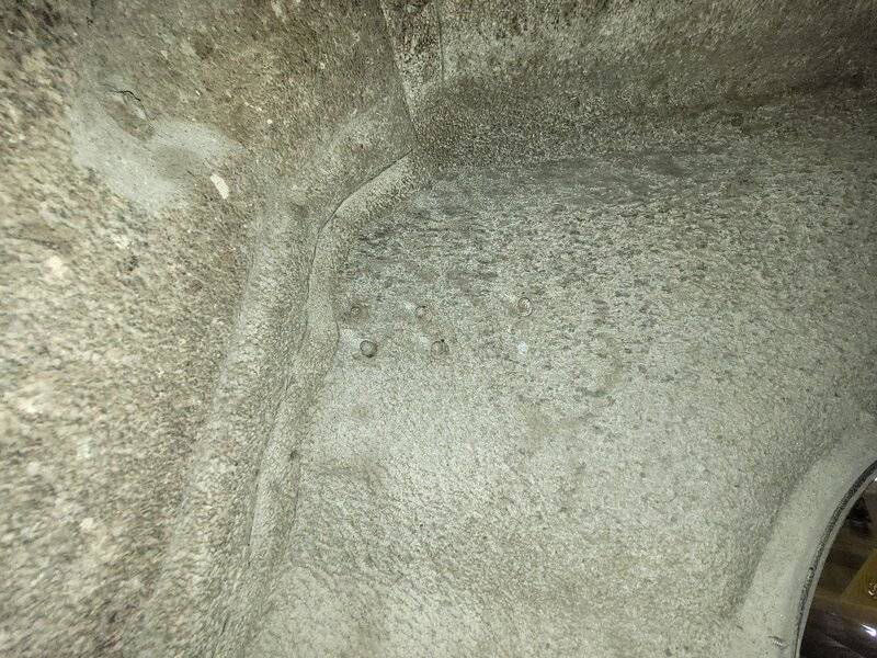

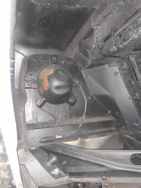

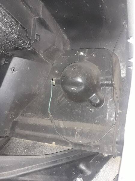

My car they are missing as shown here
I just picked up a spare right front fender that has this one./ style .
Is it Plymouth only thing ?
My 1967 coronet looks more like the 68 and later i am used to.
Is it because of the year diff.
Or model diff?
