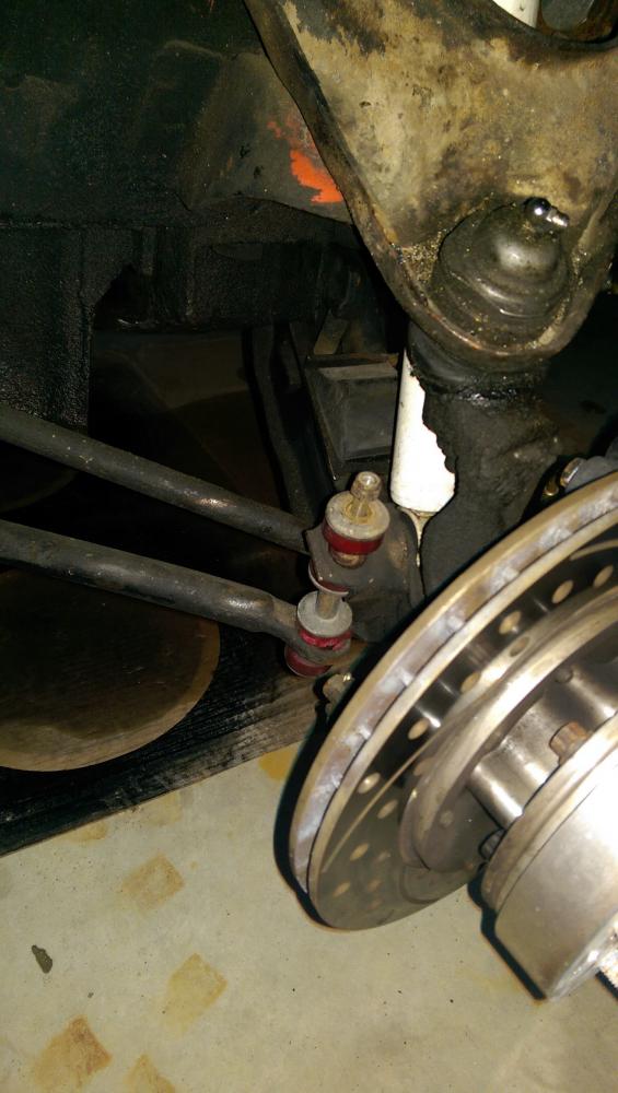

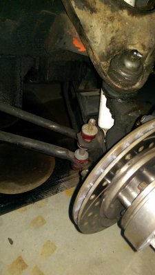

I'm real curious about the front. I went to pull out front shock but couldn't because the tie rod end links were in the way of the lower shock bold removal. That didn't t seem right to me but it was how it was. Here's a pic if the setup before I took it apart. I have new links coming! I did find the passenger side shock stuck. It would not compress at all! Not good!
The new issue is the new bilsteins don't really fit that well in the lower mount! What a pain!
Any suggestions on front set up why the end links are in the way. Nothing would surprise me with this car! Lol

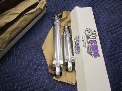

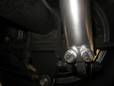

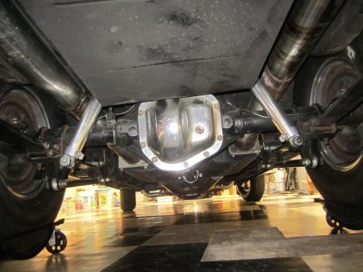

I went with the Vikings,great product and fantastic customer service:icon_thumright:
