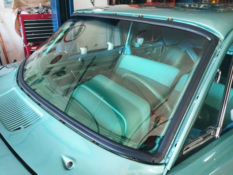

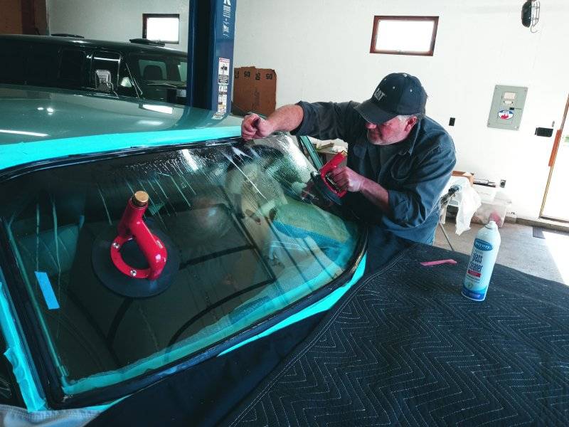

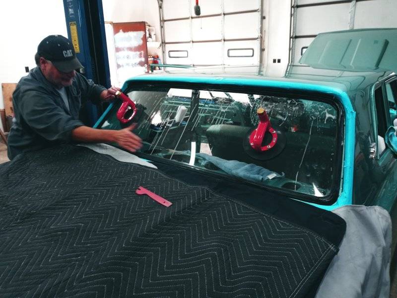

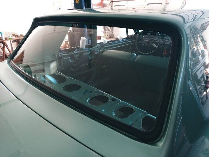

SUCCESS !!! I was thinking of some of the Great cars around our local area, and reached out to some Brothers I met several years ago. Turns out Rich used to do Glass ! I installed the gaskets, taped the body off, and they showed up at 11am today. 2 hrs later, Glass was in place, and looking Good ! A Big Thanks to Rich & Ken, the Beers were on Me !!!
