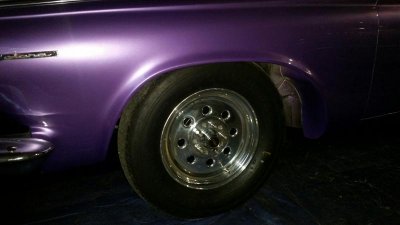

M/T Front Runners 28 7.50 15 2.25 offset 63 but close enough.
