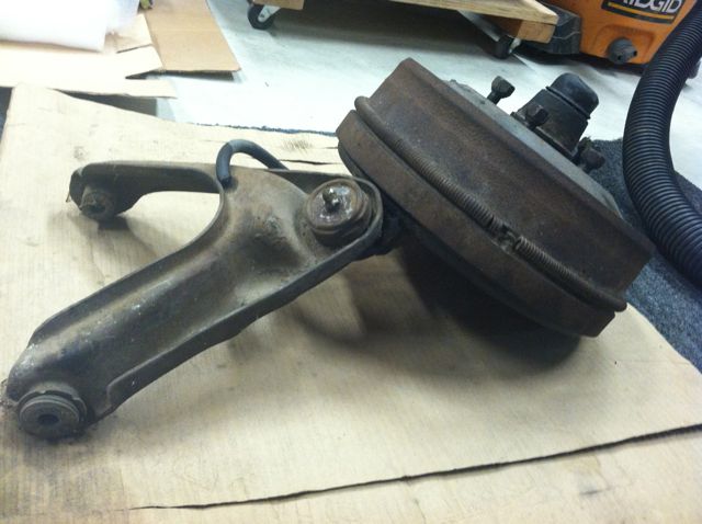

The first is: How do I get the front brake drum off of the wheel hub? Shouldn't it slide right off like the back ones do? You'll see in the first pic that I removed the whole upper A arm and Pinion and Brake as one piece because I couldn't get the drum off and therefore couldn't get the wheel hub off. I guess I could take it to a shop if I had to now that it's off the car...

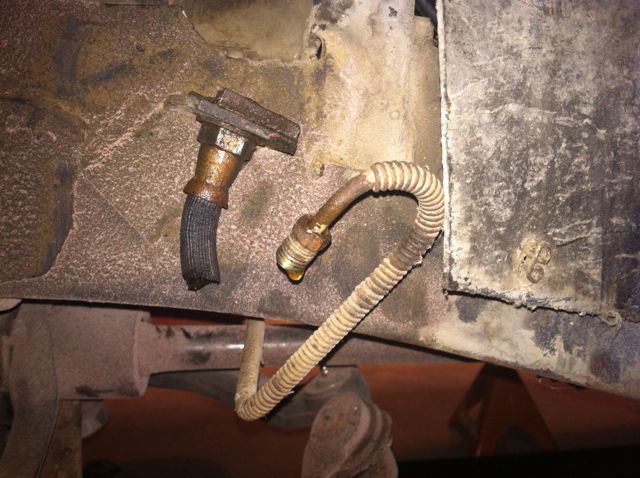

The second is: How do I unscrew (if that is correct) the front rubber brake line from the mount on the body? You'll see in the second pic that I easily removed the metal line from the mount on top (pic is the left front suspension), and that I simply cut the (scary dangerous looking) old line to remove the wheel hub. The leftover part of the rubber line seems to be swedged into the body mount. It rotates a little when pushed with a wrench, and it is shaped for a wrench, but it doesn't seem to unscrew...

Your front drum is not like the rear...The wheel studs are pressed/secured in the drum, unlike the rear.
To get it off, pop off the dust cap in the center of the drum (screwdriver under the lip-work around to pop off), remove the cotter key, flimsy key washer, big nut and washer...Walla.
Second pic......there is a horseshoe shaped brake clip on the top of that bracket, that joins the steel to rubber brakeline. You can see the outer lip of it in the pic you have posted (folds upwards). Grap that lip with a pliers than tap the pliers with a hammer down where your grabbing it. Judging by the pic you'll need to tap away from the car.
hope it helps
