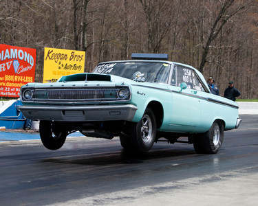

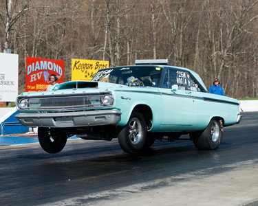

Just took the front suspension limiters out from under my control arms, it increased travel from 1.5" to 4.5"
Hopefully this puts alot more weight transfer on the slicks at launch, what do ya think..LOL
Have you been back to the track since? and how much did it affect the launch? and 60ft
What's the setup on the car and what does it run? I tried limiters, ladder bar adjustments and chased my tail and all it needed was different front shocks. 90/10's were too loose and went with a 70/30
Cool Chris.I never get my car that high.Wowzers man.It would be nice though
Cam, you dont win races going that high. i have tamed it down since. 1.28-1.29 60 foots now from 1.25-1.26 with crazy wheelies. much more manageable now.

I'm just wondering how much of a difference another 3" of front travel will make, the front needed to be looser. Stock front with 90/10 calverts, ladder bars with strange single adjustable rears, ET 9.95-10.05 131MPH 60ft was 1.38-1.44 2850lbs. Really think this car should be 60ft at low 1.3s problem is not in the back, the front was way to tight, just wondering what the extra suspension travel will do without the limiters... anybody want to guess how much improvement before I go back to the track?
im betting 1.36-1.37 for ya 1st time out
are you using a transbrake and what do you have your rear shocks set at?
which track are you going to will be the determining facter also.
Mine change from island to lebanon valley drastically.

no transbrake, only footbraking. leaving at 2500 rpms. both the 65 blue dodge and the 65 blue hemi belvedere make over 850 lbs. torque.
I come up on the converter just a little, then all hell breaks loose.:headbang:
No transbrake, footbraking to 2500 rpm, rear shocks set at 6
Hey Chris, just remember the only reason your 60' was better with the big wheelies is because the car was trppin the lights up and not out......
Worked good for me.60ft 1.55 quarter 10.67 at 127 mph.I'm happy with the set up
