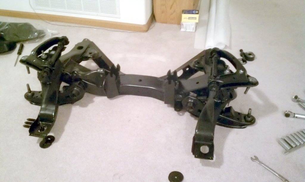

As was stated, don't powder coat threads and internal bores or things that go into the bore, like torsion bars and you will be just fine. Here is my 73 RR k-frame with suspension parts, all powder coated in 20% black.
