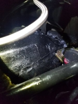

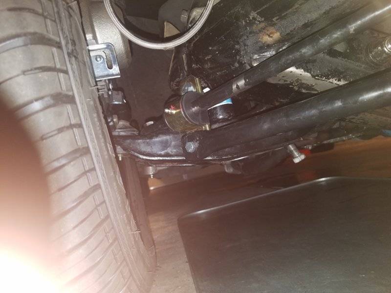

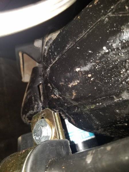

I finally was able to get the car's front end aligned I was driving it around I could hear some thing hitting on the front end . I pullled into my garage and looked underneath and there witness marks where the brackets are hitting the K frame I reappointed the K frame before I installed every thing. Now What ?

We need more details Doug. OEM bar? After market? Was car originally equipped with a antisway bar? Further back photos would help too.

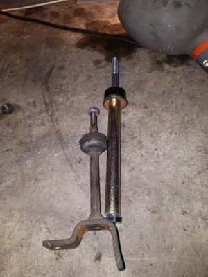

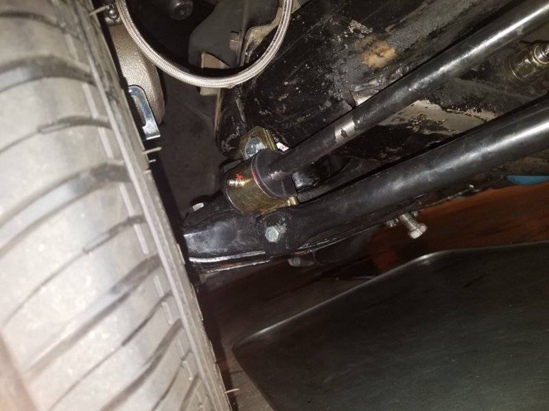

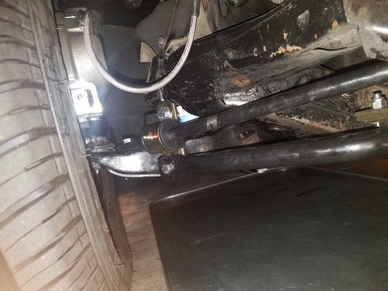

I think you might be able to cut the corners back more on the strut bushing brackets. And/or heat the K member area with a torch and smash it back for more clearance. As another option-the bushing bracket could be cut off at the top (down to end of bolt slot) and welded together. It should be done on the bar and then slid into operating position and bottom clamp bolt snugged up. You may never remove that bracket in your lifetime! If ever needed- buy 2 new brackets.

This is confusing. First oem bar hitting K frame. What changed from stock other than the bar? Bolts can be bought anywhere. They are not special.
Then pictures off rear bar. You have a problem there also?
Also unless you know how to re-temper spring steel I sure would not recommend heating and bending of bars.

Time to EAT CROW I'm sure most guys on here wouldn't do this because your always right lol. But I found the reason why the front sway bar was hitting the K frame I think I haven't watched my GOPRO yet I video'd my suspension to see what's going on since the first video. After the first video I inspected all my work again trying to figure out why the brackets were hitting the K Frame. I installed the sway bar up side down how I didn't I catch that when I installed it I don't know. But I want to apologize on here to James and the whole PST company for voicing my complaint on here. I'm not perfect I make mistakes when I do I always make sure the person or company knows I made a mistake. I'm sorry for any stress or anger I caused.
