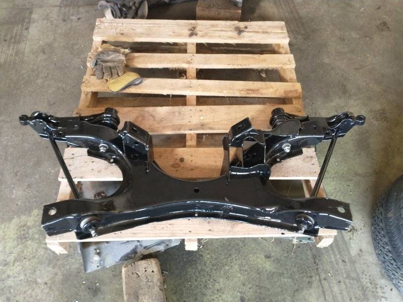

My question is where/how does the swaybar mount to the K-Member? Any pictures or drawings would be most helpful. I fount two holes on each side of the K-Member but not sure if those are the ones for the hardware.

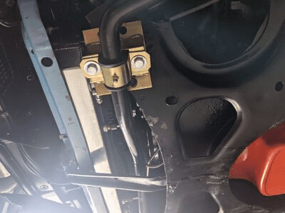

This is what mine looks like:
Thank you in advance for your help!

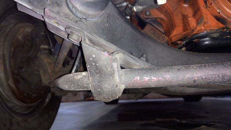

Here's the nasty old originals on Fred before I got under there and re-did everything (he's a 1968, recall):
Hope that helps?
Those two holes you are pointing to are the mount holes for you 70. I posted a picture of one mounted in your last thread.

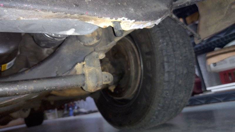

Here is the pic of a factory one mounted.
found a couple pictures from working on my 70 Charger
You can see the holes and the other picture has a small piece that goes across the holes so the bracket can mount the sway bar to
I did not take any pictures from the bottom
Awesome guys thanks a million! So the holes I pointed out are correct and I don’t need to drill any thank god lol. Ge would be nice to use factory style brackets as the plates that come with the kits look cheeky.

I just found an image of a bbody install using the same kit. This:
Hold on that may be a bbody and a PST swaybar BUT ITS NOT GOING THROUGH THE Kmember. Must be the aftermarket type?
