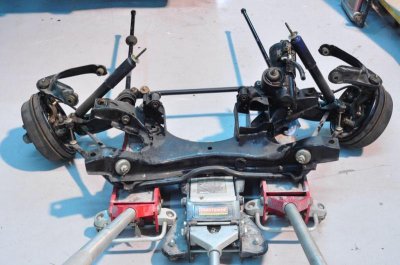

I bolted a 69 b body sway bar into my 64. Just drilled the bolt holes in k member lip for 69 mounts and bought Hellwig shock mount L bracket for ends. They were cheap from hellwig and sway bar free. Done this for last 3 cars and have had no issues.
Example photo to show where brackets mount at front of k member
