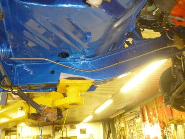

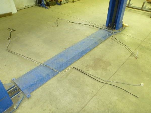

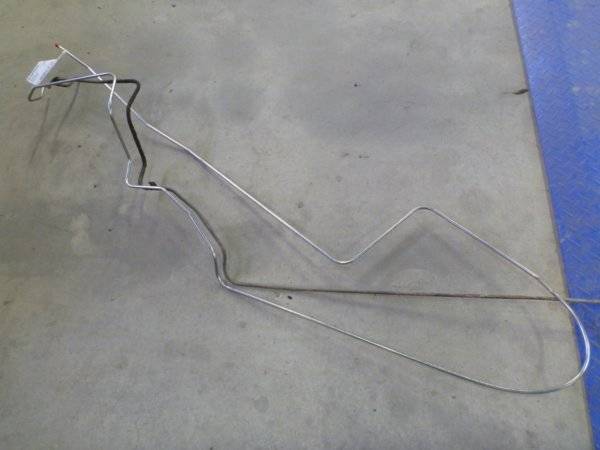

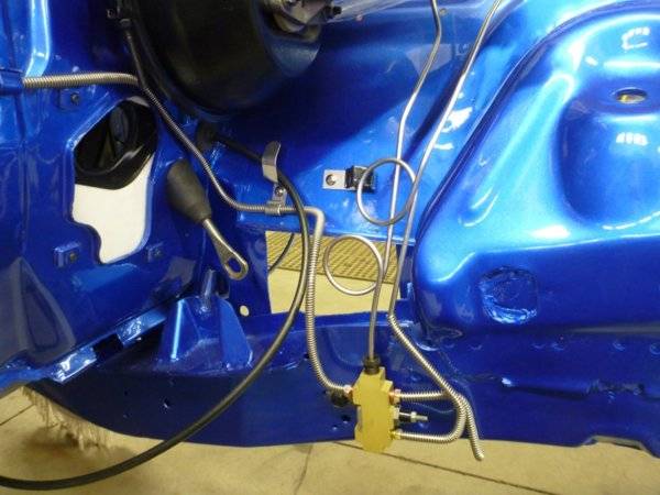

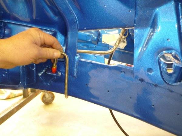

Got my stainless brake and fuel lines from Right Stuff and everything was spot on, other than one bend at the front of the fuel line as it comes up the front frame rail, just before the pump to line hose. Bend was a bit further down the pipe than stock and needed some minor adjustment. Key is carefully removing your existing for an exact pattern, whether you go bought or fabricate yourself...as even the bought get rolled to fit in the box! Note that I couldn't have bought the line and fittings for the total cost of the kit!!
