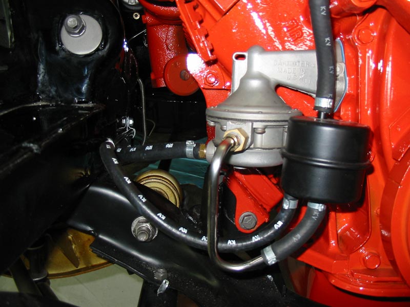

What you are showing is not a filter. It's a vapor separator. The filter would still go in that approximate location though.
if i put my filter where that separater is, do i just go up alittle with rubber hose then steel line to the carb.. or hose the rest of the way up...
The line to the carb is definitely steel and it terminates somewhere below the alternator. I think a short hose coupling after the vapor separator to attach the filter and you're good to go. I personally like to keep rubber hose to a minimum.

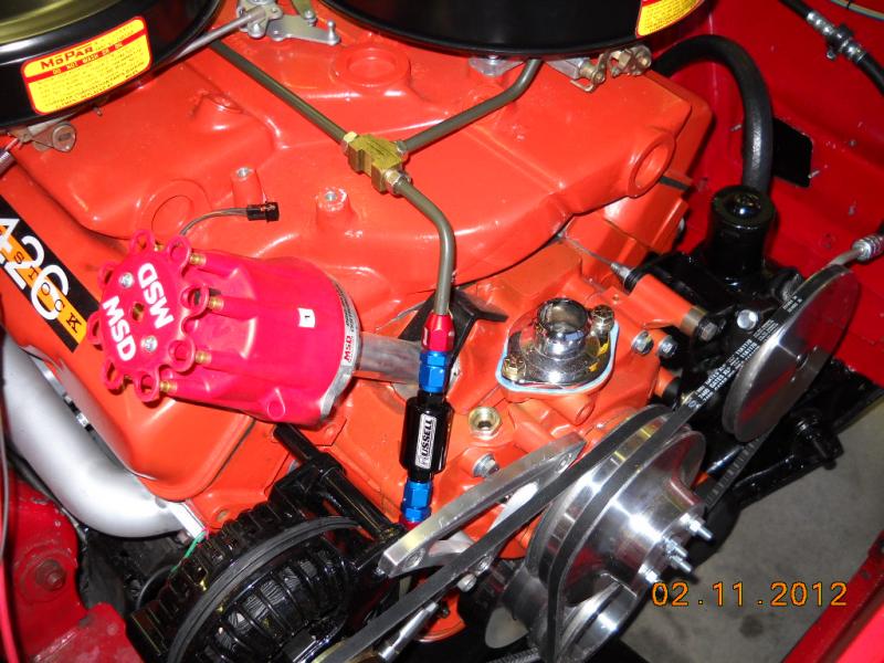

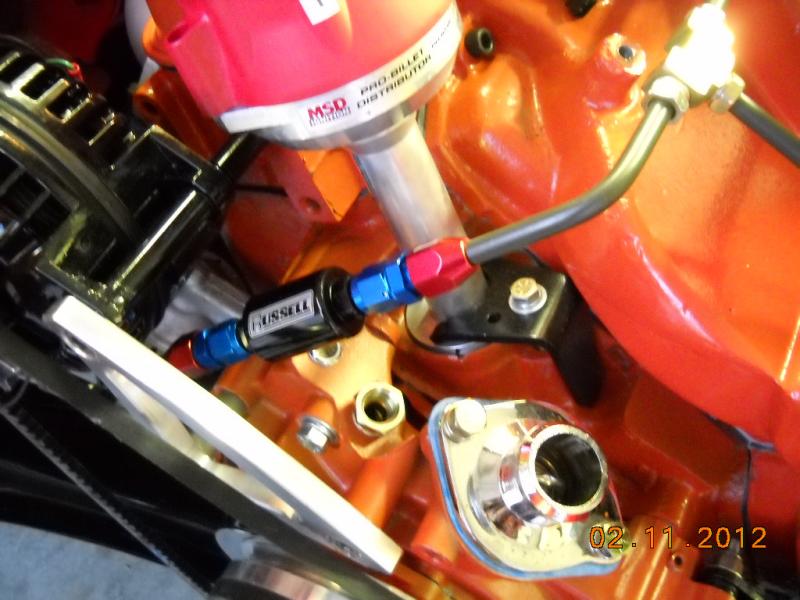

Agreed. Pressure (carb) side of the pump. Here's mine:

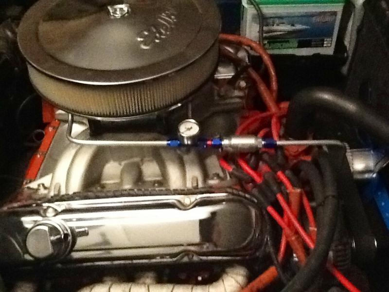

Here's mine. Just plumbed it the other day. The filter is a summit 40 micron unit my dad gave me.image.jpg
Originally the filter was under the alt. with steel line up to the carb.
Steel line is 3/8" cut from 48" pieces I bought at Napa Auto Parts. Used a tubing bender and flare tool (cheap at Harbor Freight). The filter (cleanable 40 micron stainless mesh) and AN fittings are from Summit. Thanks for the compliment.
