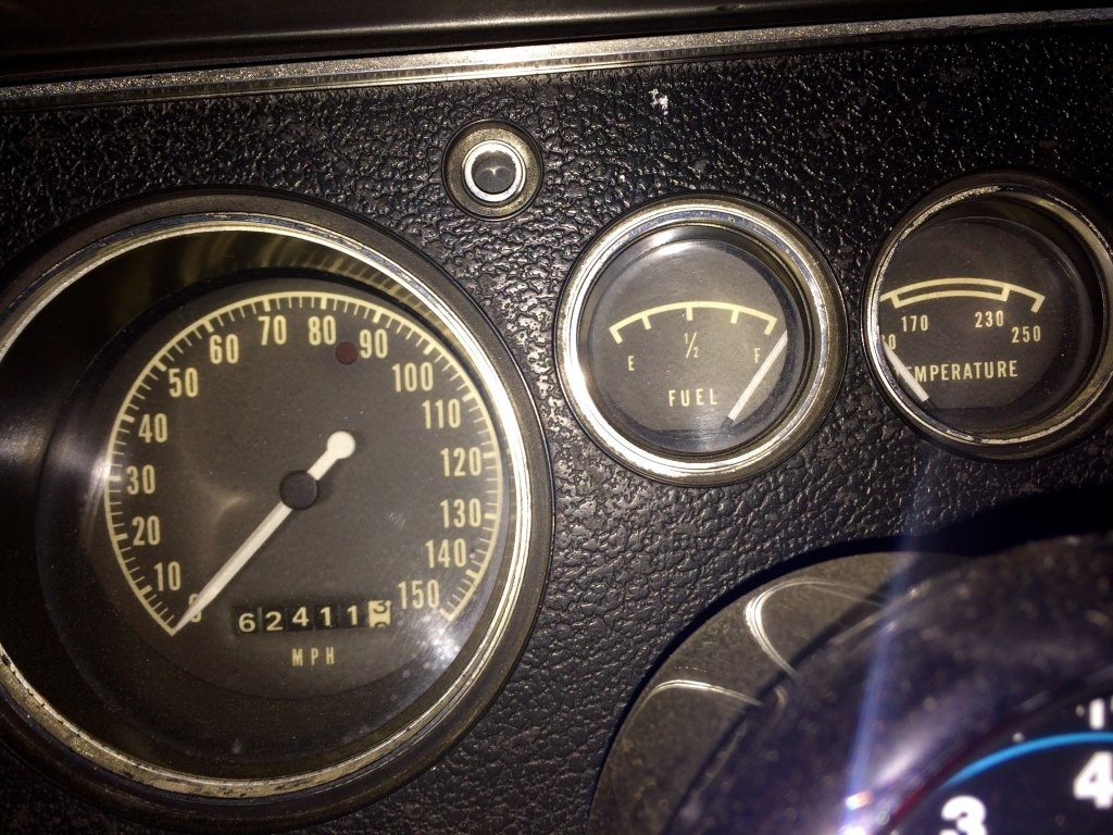

My Tech Ted @ Valaya Racing in San Jose says it was a bad ground. Not the ohms, not the sender itself. Owned the car since 1988 and have never seen it read full before. Ever.
No, would not go past 2/3. Always worked, but weak.
