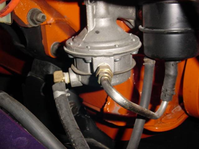

Can anybody send me a picture of the vapor separator mounted?

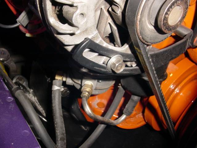

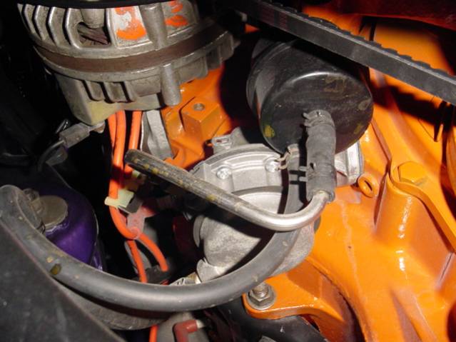

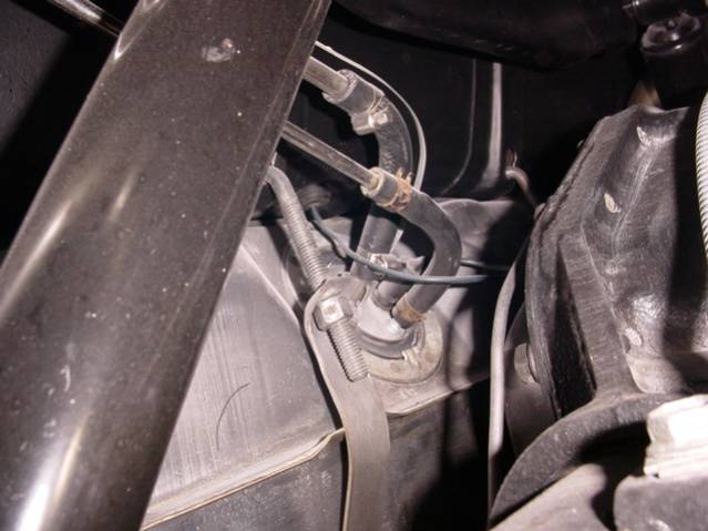

Here`s a setup on my 70 440 6 PK . You can see there`s not much room but that it`s all there & working fine. Top pic 1st then from the bottom and one of the hook up for the 3/8 & 1/4 @ the sending unit. Hope these help. Fred

My mechanic will not install the return line, he still claims that it won't fit!
He now says that the vapor separator won't fit next to the fuel pump and the best way to deal with the pressure in the tank is to drill a hole in the NEW gas tank!
