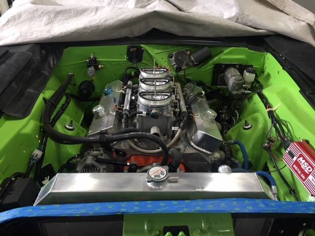

I personally have 2 EFI 6 packs and am currently putting a Fitech "Tripower" system on a car for a client. I have run carb 6 packs since the late 70's so I am very familiar with both systems. Every time this subject comes up there is a onslaught of "don't do it" "learn the carbs" guys and while the carbs are not necessarily a bad thing they can (and usually do) create a lot of pain for someone not intimately familiar with them and someone who does not drive the vehicle frequently.

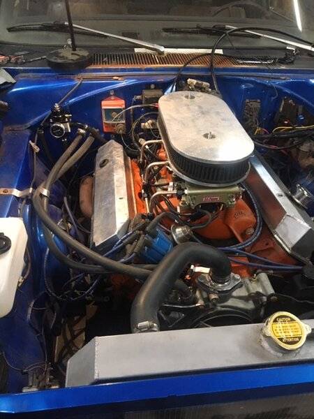

No problem, happy to try and help. I know that EFI is a source of issue on all of these classic car forums. For a long time I was one of those who didn't want anything to do with it because I didn't understand it. Then F&B came out with their 6 pack system and I was building my Cuda and subsequently decided I wanted to try it but it would be some time before I got around to installing that system. However, I did install another one onto my 70 Challenger (440 AT) and a Fitech system onto my 52 Dodge B3B (w/56 Desoto 330 Hemi).
I am by no means an EFI expert, there is a lot I don't know but I have installed 4 systems so far and have helped installed another 3-4. I am still learning the tuning aspect but I can definitely weigh in on the installation aspect.
