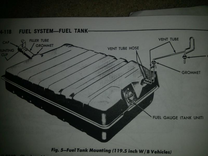

Those vents do not go into any kind of filter. Just open to the air. Your return for your tank is a vapor return line on your 44+6 system. If you run that system, you'll need a fuel vapor canister. Below is a good thread that points a few things out with that type of system. One benefit of a return type system is drastically reducing the chance of vapor lock/fuel boil because the fuel is not deadheaded and sitting up at the carb(s) when not being used. You're car will run without that setup. More folks around here running 440+ engines around here don't have them, but definitely are a good addition. If you're not going to use it, cap it off with a hunk of 1/4" rubber fuel hose, a bolt and a hose clamp. Good luck.
