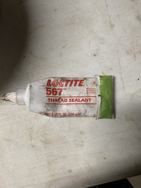

the company we used to assemble for specified on blueprint locktite 567 on all threaded connections . no teflon tape ever , anywhere on there product . it is a thread sealant and i admit works well , i don’t ever remember a leak at a thread during use . if your experiencing a leak at a tapered fitting (an3 / an4 style ….) that is a different problem.
p.s. an afterthought- this sealant is said to have an anitseeze technology, as a thread lubricant during assembly. especially if your using stainless steel it lubes the thread during assembly preventing galling….
