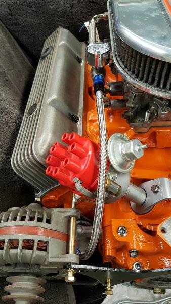

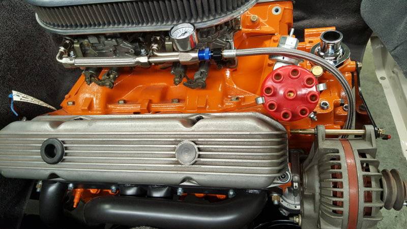

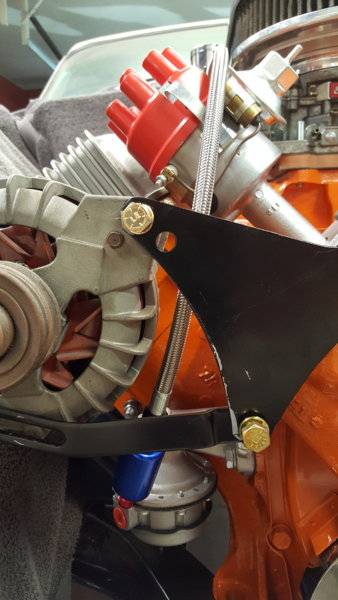

On my dual fours the gas line really gets close to the distributor so I used a braided line with AN fittings. I don't believe it was that expensive. I found what I needed at Summit.

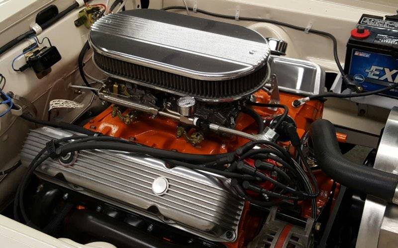

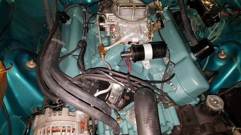

I have a six pack but you can see how mine routes just above the distributor

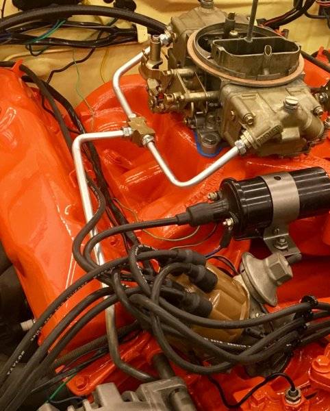

I was in the same boat. I made my own, cost me about 20 bucks. I made mine out of 3/8 aluminum fuel line and fittings from Napa.
